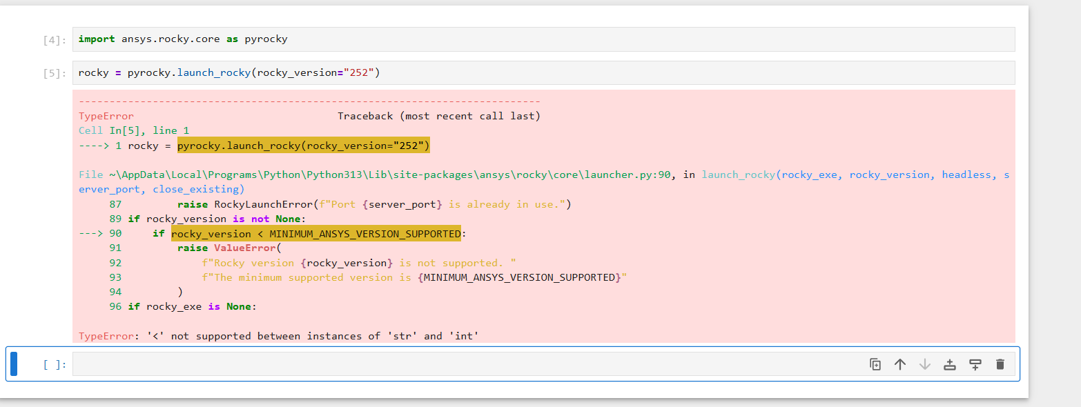

saif.ansari
Subscriber -
August 21, 2025 at 4:07 pm
Jackson Gomes
Ansys EmployeeHi saif
Your issue is that pyrocky can’t find the Rocky executable/version.
Try to specify the rocky version:
rocky = pyrocky.launch_rocky(rocky_version="25.2")
