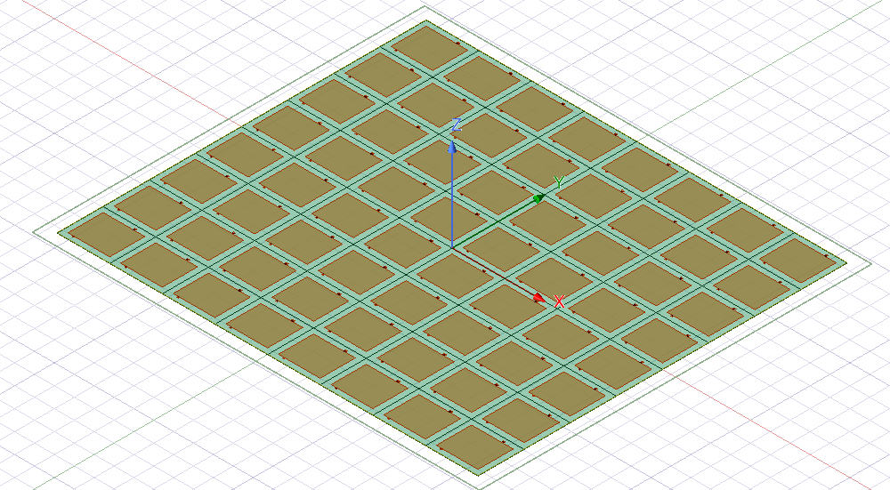

      I am currently simulating a Reconfigurable Intelligent Surface (RIS) in HFSS and have encountered an issue that I hope someone can clarify.
      Setup:
      • Each unit cell contains lumped R/C elements.
      • When I simulate the unit cell with an impedance sweep, the S11 clearly varies with the impedance values, which confirms the elements are being modeled correctly at the unit cell level.
      • To build the array, I duplicated the unit cell geometry (instead of using “link/array” commands), since I need to apply different impedance values to each element of the RIS.
      • For the open region, I am using an FE-BI boundary condition.
      • Excitation has been tried in two ways:
        1. Incident plane wave.
        2. Illumination with a horn antenna.
      Problem:

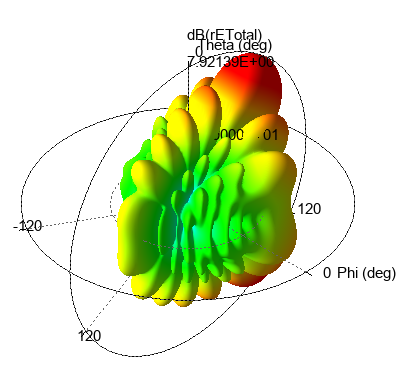

      When I simulate the entire array, the far-field radiation pattern looks the same whether or not the lumped impedances are included. I expected the reflection phase/amplitude variations from the lumped elements to change the overall pattern compared to a uniform reflecting surface, but no such variation is observed.
      Question:
      Could anyone suggest what mistake I might be making? Is there something specific about:
      • How lumped elements are treated in arrays,
      • The boundary condition setup (FE-BI), or
      • The excitation method (plane wave vs horn),
      that could prevent the impedance variations from influencing the radiation pattern?
      Any guidance or suggestions would be greatly appreciated.
      Thank you!
