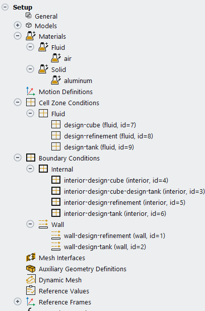

      How many cell zones have you got?  Staff are not permitted to open/download files/links so a few images would be helpful.
    • LeviPesin
      Only three of them. Here's the project tree:
