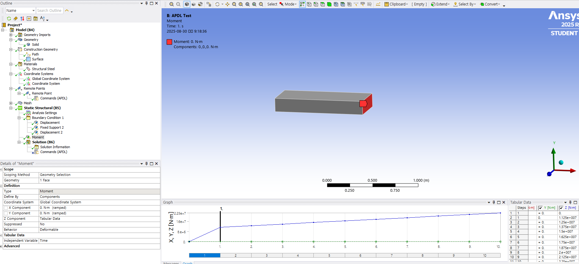

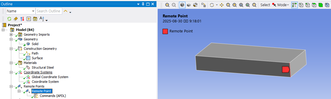

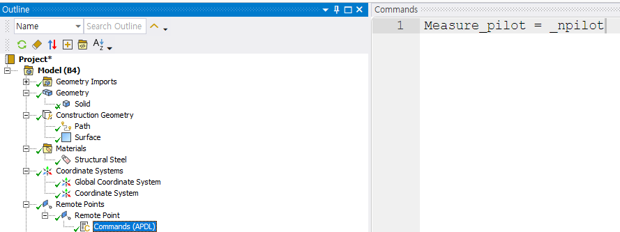

      1.Assign a Remote Point and link the data of the corresponding edge to Measure_Point through a command.
      2. Apply a moment using a tabular input, divided into a total of 10 steps.
      3. In Solution → Command (APDL), when applying the moment in 10 steps, write code to extract the rotation angle at each step.
      Problem: In this state, the results cannot be viewed in the Result section.
      I think there’s an issue in the code—how should I modify it?

      Issuing 'SET' command calls the data from rst file which doesn't store the variables. Hence the variable 'Measure_Pilot' will not be recognized by the post command unless you resume the database file first.
      I would suggest saving the db file and resuming it in the post command using the APDL command 'resume,,db' in the first line of your code.
