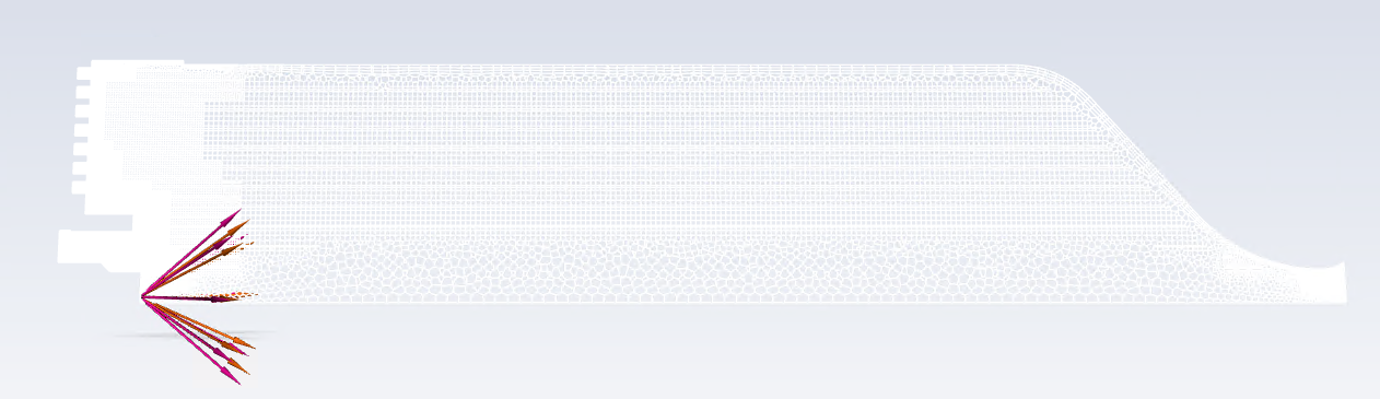

For the pressure swirl atomizer injection properties, I have specificd the azimuthal start and end angles as 0 and 22.5 degree. Despite this, the display shows a 360 degree cone and the droplets are sprayed outside the domain (22.5 degree wedge). When I run the case, I also get an error saying the droplets were sprayed outside the domain. -

SubscriberI was able to solve this issue by moving the injection point slighly into the domain. Initially, I had set the injection point at one of the vertices of the wedge but it gave me the warning (as mentioned in my first post). When I ran the case after moving the point into the domain, it did not give me a warning but the position of the injection point does not accurately represent my test article because it is not at the vertex (desired) but inside (actual) as shown in my schematic below.

SubscriberThe issue with my current apporach is that it models an injection point in one wedge, which due to the periodic condition causes there to be multiple injection points. In reality there is a single pressure swirl atomizer at the center (vertex), which sprays fluid into each wedge. This should be a common scenario, wonder how is such a case setup.

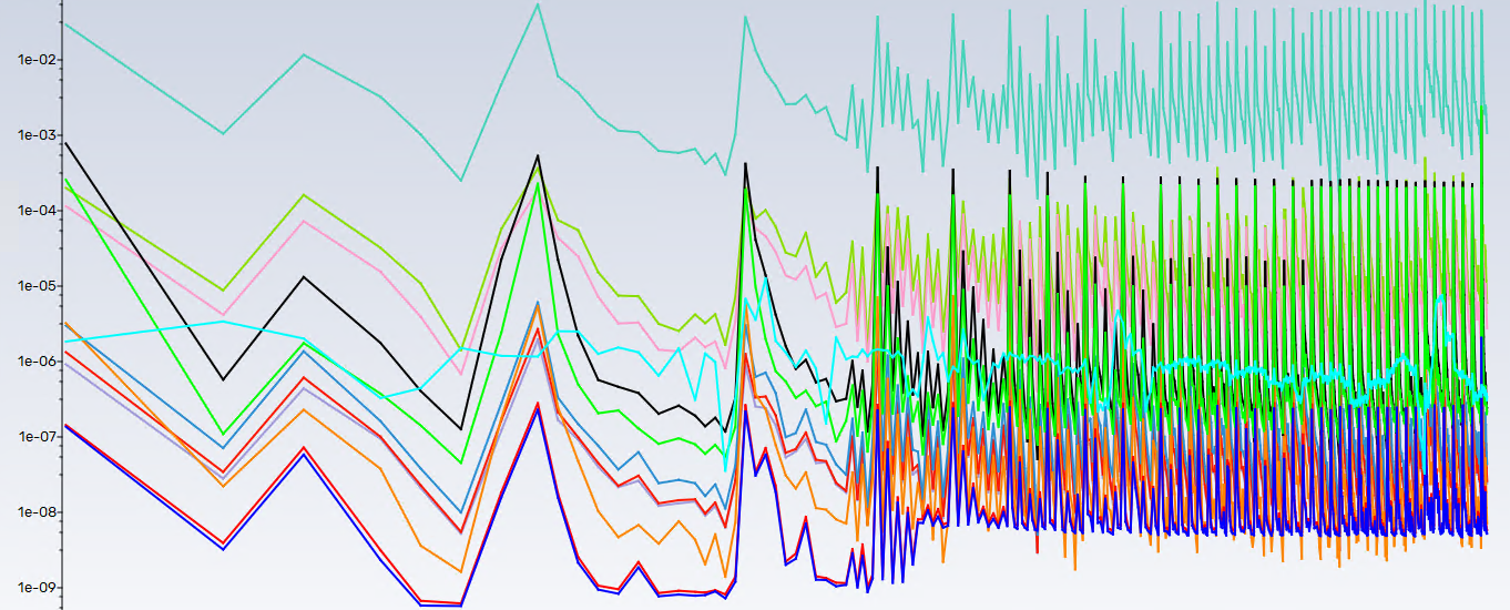

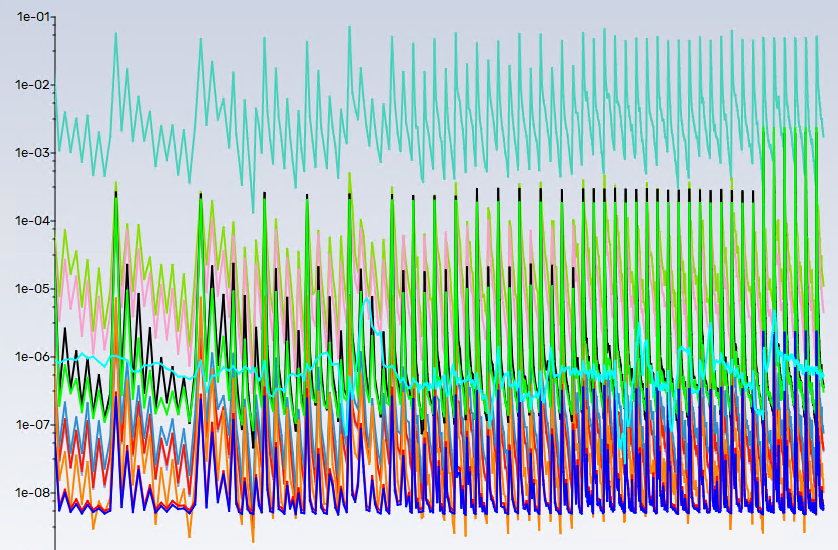

SubscriberI have restarted the 16 stream case and the residual (black) for the species involved in DPM, evaporation, and reaction (reactant) rose abruptly. Similar abrupt change was seen in one of the products. These trends may simply indicate that appreciable reaction is occuring as more reactant mass is spray into the domain. The contiuity residual (teal) started climbing but still would drop below 1e-03. In response, I reduced the time step from 1e-06 to 8e-07. The energy residual (organe) still continues to drop below 1e-06 at every time step. (I am not using residuals as convergence criteria similar to the tutorial example on modeling evaporaing liquid spray).

Forum ModeratorHow are the velocity, temperature and species concentrations looking?Â

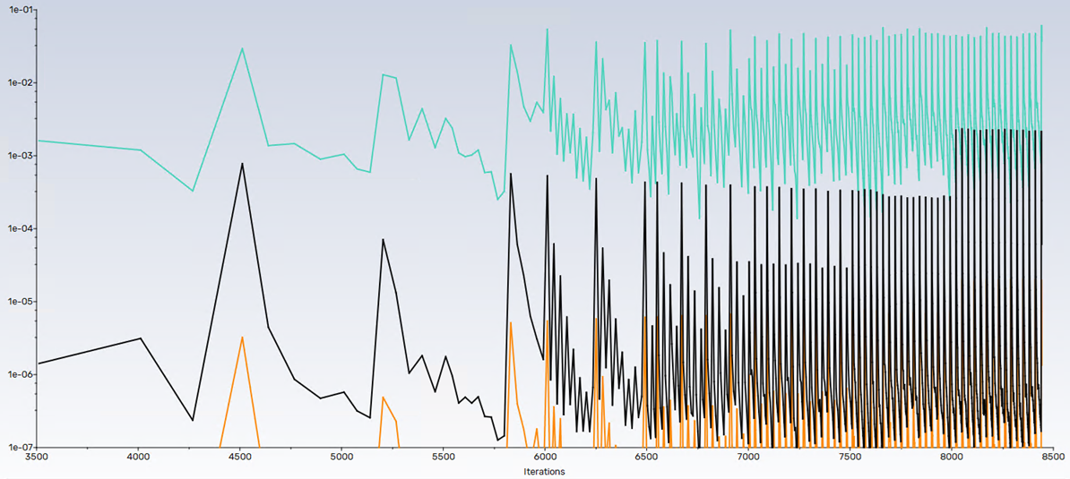

The spatial discretization for the species is second order upwind and the associated under-relaxation factors of the species is 1. Do I need to reduce the URFs to improve the drop in residuals per time-step?
In the plot below, x-axis is from 8000 to 10000 iterations. Teal- continuity, black -reactant species, green-product species, light green - k (turbulence), pink-omega (turbulence).

Forum ModeratorResiduals are a useful tool, but I'd always look at the flow field too. A time step of 1s is perfectly fine in one model, whereas 1e-9s is required in another so that's "just" a setting rather than being a sign it's working. I'd also always make sure I did 3-4 iterations per time step now too - that usually means the solver can't just jump through a time step because the convergence criterion were hit too early.Â
