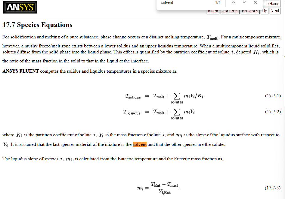

Forum ModeratorYou may want to read  https://ansyshelp.ansys.com/public/account/secured?returnurl=/Views/Secured/corp/v251/en/flu_th/flu_th_chp_melt_freeze.html The model isn't overly intelligent so if the alloy results in "odd" material properties you may need to use a UDF or rethink the approach.Â
