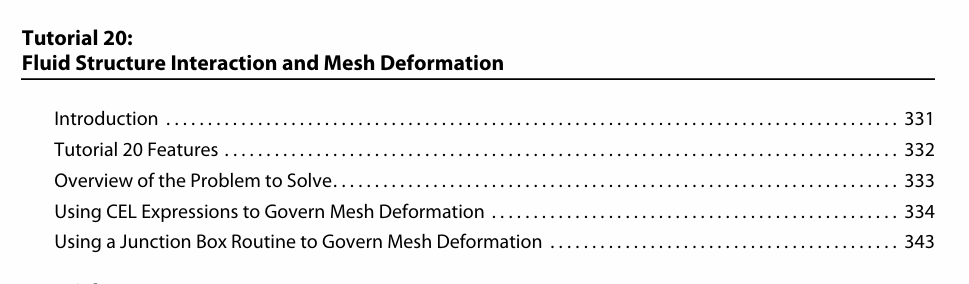

      Thanks for your answer. You are right in that without the source term from the fluid, particles cannot move. But in my case, particles already have an injection velocity at the beginning, so they are gonna move. Now the domain in which they are moving has two aspects: 1) Momentum source from the fluid solution used to initialize the simulation (think of a frozen fluid state) 2) Rotating parts in the domain. So particles would experience drag force and rebound forces from the walls of the domain (where I specify rebound models). If it is not clear, I want to load different .trn files at the end of each timestep of the simulation, so that particles experience fluid forces even if fluid solver is turned off. I think it is possible as I found an example from an old tutorial in CFX 11.0 where mesh files are loaded at the end of each timestep of a transient simulation, using junction box routine. Do you know if I can load .trn files similarly? I have attached a ss of the tutorial for your reference, unfortunately I couldn't find the fortran source codes for the junction box routines used in the tutorial and available in CFX 11.0 installation.
