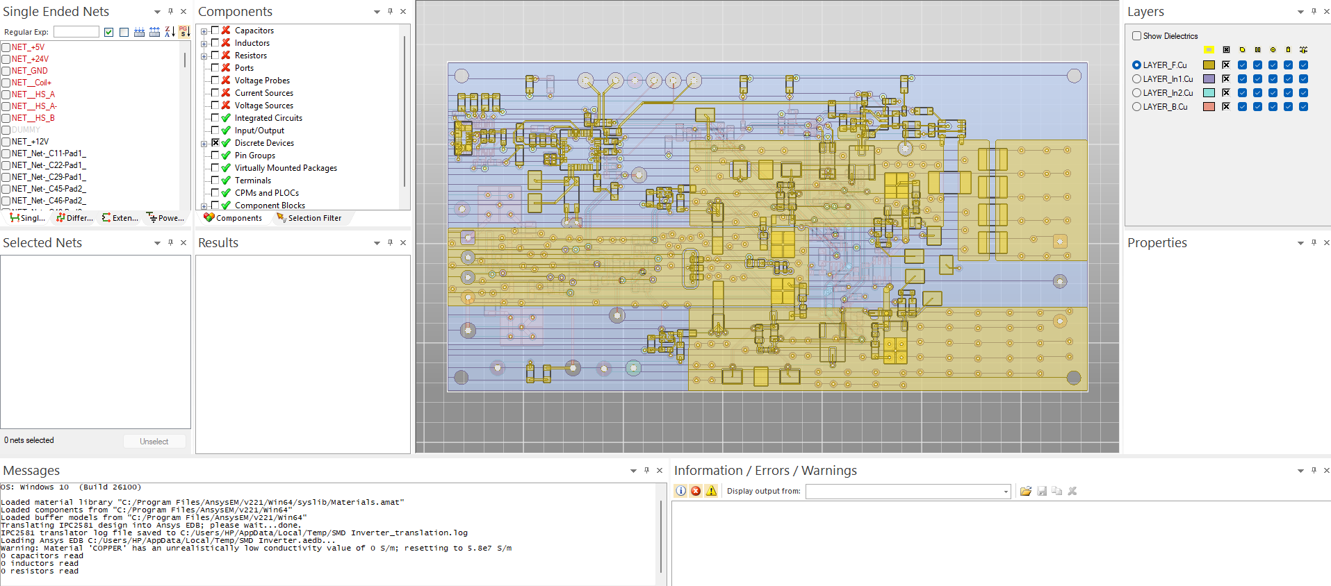

pradhan.5
SubscriberThank you for your valuable input.
August 27, 2025 at 6:54 am
pradhan.5
Subscriber -
August 27, 2025 at 7:32 am
Takeshi Itadani
Ansys EmployeeThis is a DCIR analysis without any passive components mounted. Nets that are not connected by R or L are treated as having no continuity. If you want to analyze the characteristics of passive components as well, please set up passive components in SIwave.
