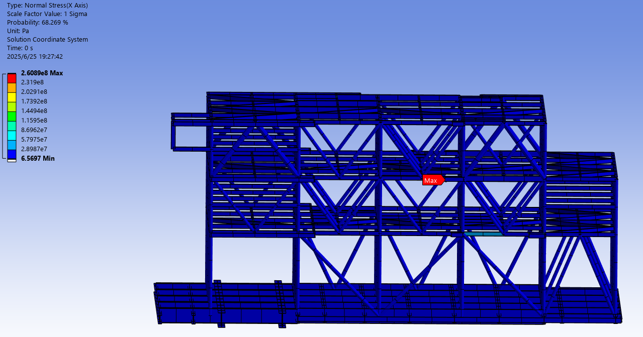

      Hello guys. I built a space frame structure model with beam 188 element and run random vibration analysis on it. But the normal stress distribution seems to be wrong. Can u help me find the possible reason ?
      I choose 9 bottom point as fixed support and apply displacement psd on Zdirection.

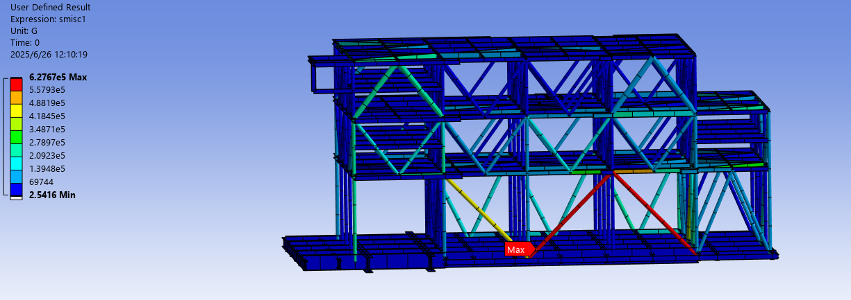

      Beam postprocessing, especially after a psd analysis, can be difficult.  As a sanity check, could you try displaying the axial stress with the user defined result below?:
    • zengmin
      Thanks for your reply. The result is below:

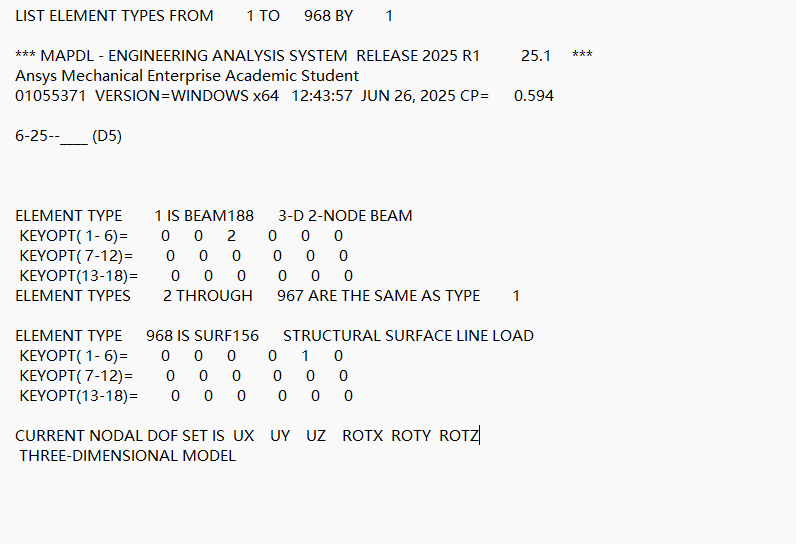

      I also added distributed mass and made prestress for modal analysis.But it doesnt effect the normal stress distribution. Here is all my keyopt. They are all default.

      Prestress doesn't always change beam results.  There is a nicer capability for displaying beam results on the cross-section in APDL:
      /post1
      set,last
      /graph,power
      /esha,1
      /show,png
      plnsol,s,x        ! beam axial stress will be displayed over a 3D image of the beam
