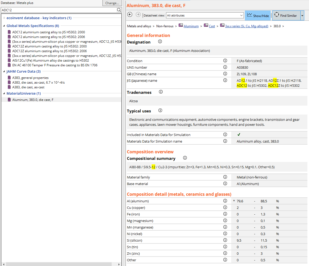

David Mercier
Ansys EmployeeHi, For most of the materials you’re looking for, multiple datasheets are available in both the MaterialUniverse and JAHM databases, including temperature-dependent mechanical properties. Export tools are available to connect Granta (either Selector or MI) with Mechanical and other simulation environments, enabling seamless transfer of data from the databases into your simulations.
