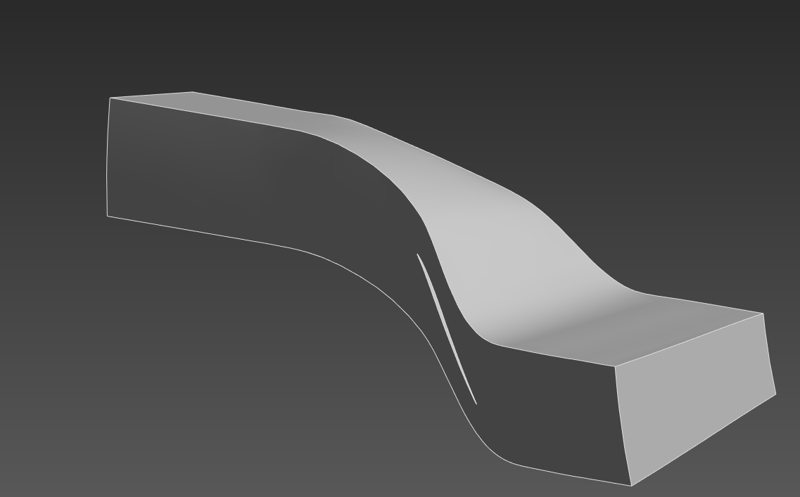

      I have created a geometry for rotor 37 that I am using for a casing treatment study meaning no turbogrid so I am using ansys meshing. I have done very little meshing and I am wondering what the best practices/settings would be to get a reliable mesh for this model? I am mainly wondering about sizing, whether I should use capture curvature or capture near the blade in other ways, and how to use inflation. From what I have seen, I believe elements should be near a million and nodes around 200,000 to balance computing time as well as being detailed enough. Let me know what you think. Thanks!

      Depending on the type of casing treatment you can also have a look at high fidelity meshing of TurboGrid. This will help to keep the mesh count low as only the area near the tip will use unstructured elements.
