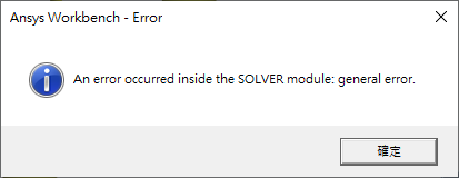

A lot is happening in your model, essentially pointing out that the model is not correctly configured.
To get some clues about your first error, please check the d3hsp and/or the messages files, which are located in the solver directory. These files provide us with details of specific errors that occurred in your model, allowing us to address them accordingly.

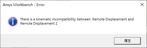

For the second error, check if you are applying multiple boundary or load conditions to the same set of nodes, or in situations where the displacement of that node is given by two sets of kinematic equations, which are not necessarily compatible. One node can not belong to more than one rigid zone.

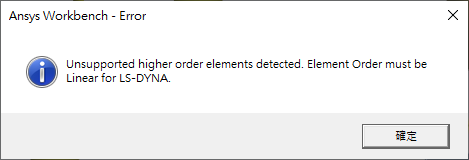

For the third error, in LS-Dyna we don't support higher order elements up until a few versions down; however, check if you find Pyramids, Wedges, etc in your mesh, if you find them, correct them by adjusting the local mesh size, etc.
