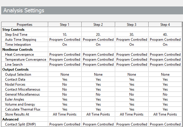

      The other may be easier approach is create multiple load steps. For example first load step may be from time 0 to t1 (corresponding to track 1), second load step from t1 to t2 (track 2) etc. You can then create mulitple command snippets - one for each track. In the details of each command you can use the 'step control' to specify when the command snippet should be used.
      NOTE: You must remember to delete the previous track loads at the beginning of each snippet (SFDELE). Otherwise those loads will still be active.

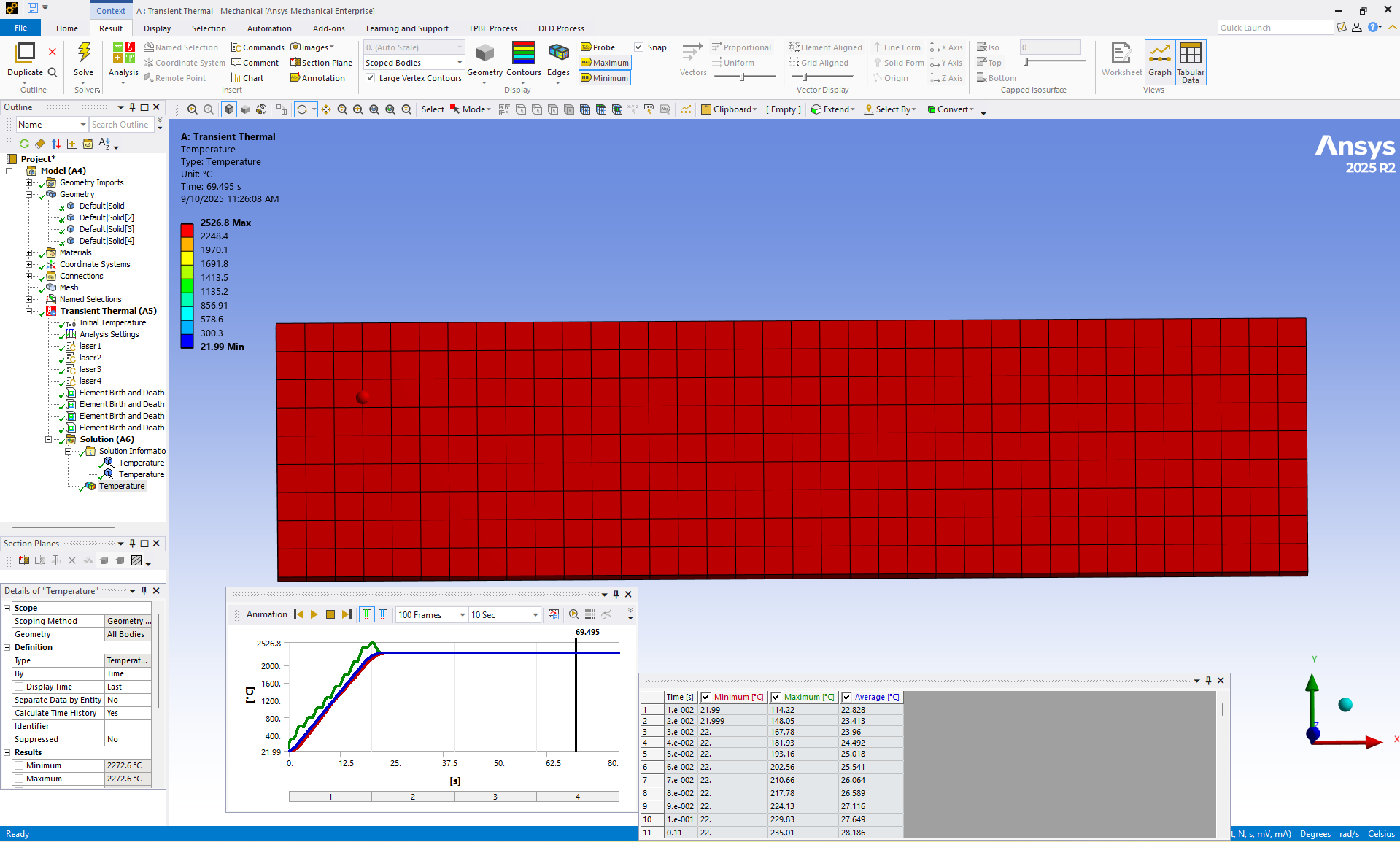

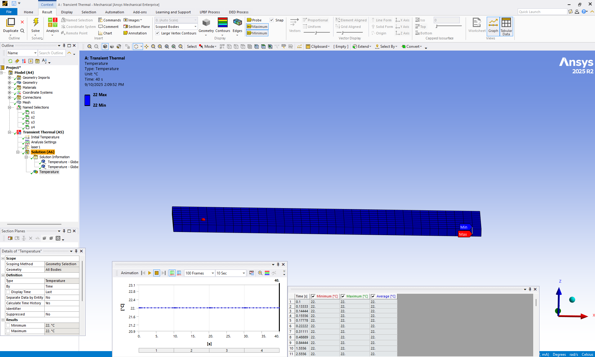

      I obtained the 4-regime equation from MPDL and tested it in different ways. First, I placed the entire command into a single file and applied it to the model, and then I tried applying each laser track in separate commands. In both cases, I couldn’t get the correct results (see screenshots below).
      • When I placed everything into one command file, no heat flux was applied to the surface at all.
      • When I separated the commands, only the first step produced results, and the flux was not activated in steps 2–4.
      I am wondering if I want to seperate the command for each laser track, where should I put the first part of command which is"time equation"
      Below is the command:
