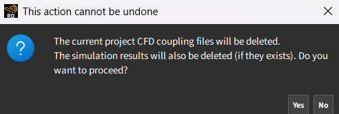

I performed a CFD-DEM simulation using Rocky and Fluent without domain rotation. I would now like to restart from the final data, this time applying domain rotation. I saved the case as a new project for restart and uploaded the Fluent
.cas.h5
file, which includes domain rotation, in the CFD coupling section. However, the Fluent data was lost. Could you please advise me on how to correctly perform this restart? -

SubscriberFrom Rocky, I go to the last time step and select File → Save Project As to save it as a new project for restart.
Then I open the Rocky for-restart file and go to CFD Coupling → 2-way Fluent → Fluent → Case File → Load to load the new.cas.h5
Fluent file, which now includes domain rotation. However, I see the following message, which I think is the reason why the CFD results are deleted.Is there a way to use the Fluent file with rotation while keeping the final CFD results from the test without rotation?
