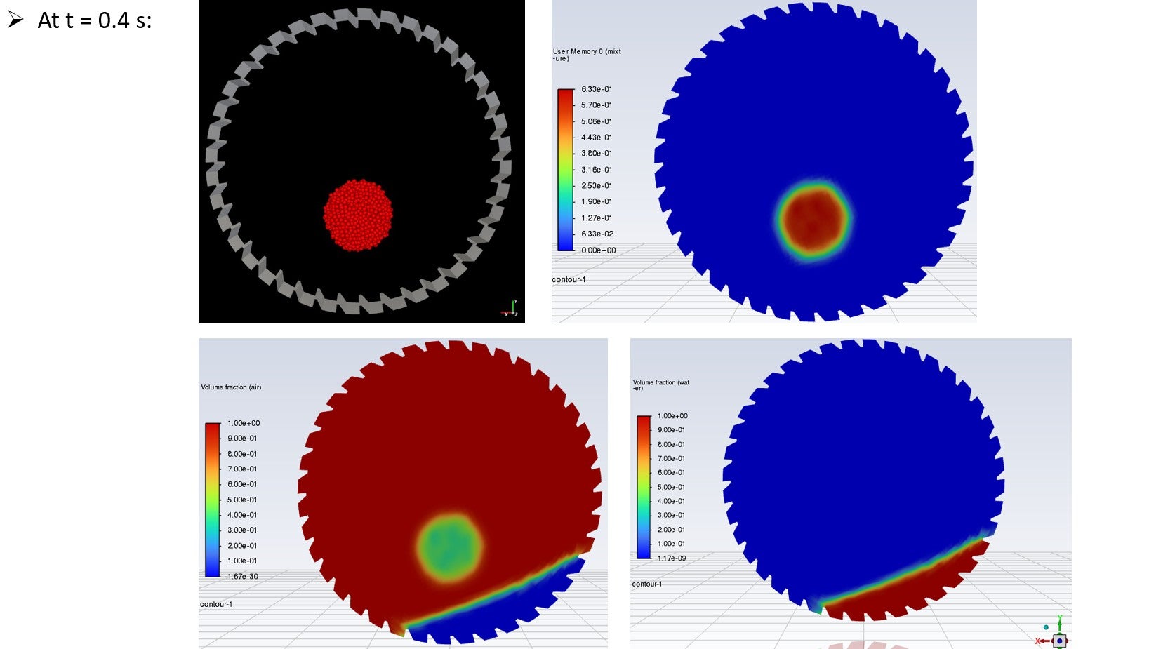

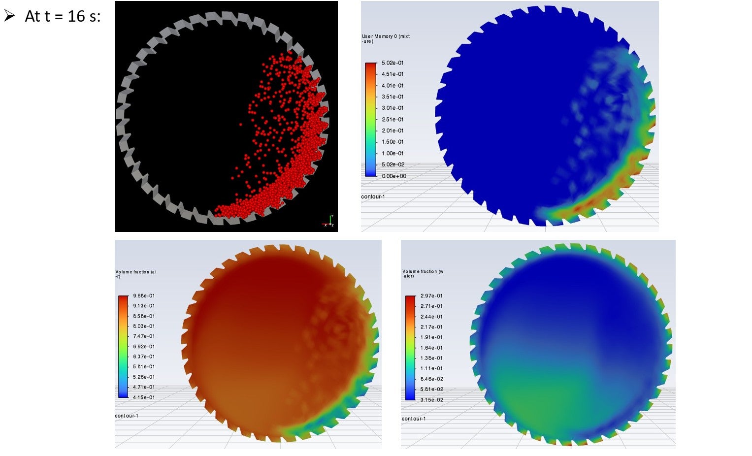

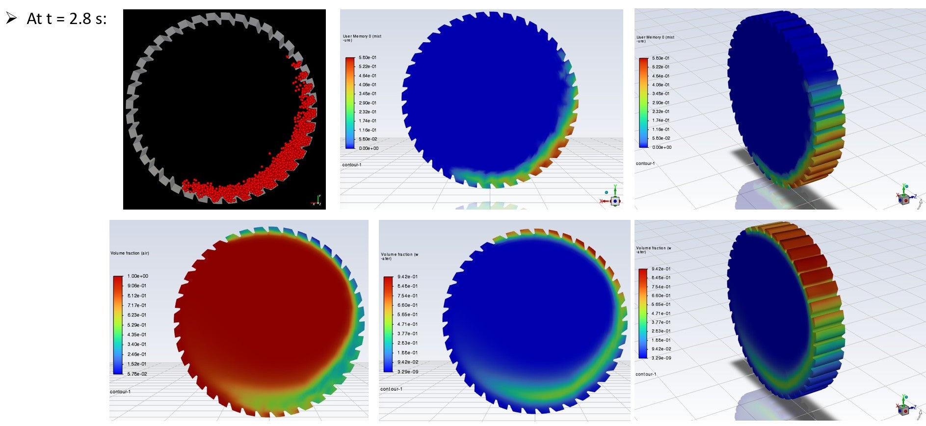

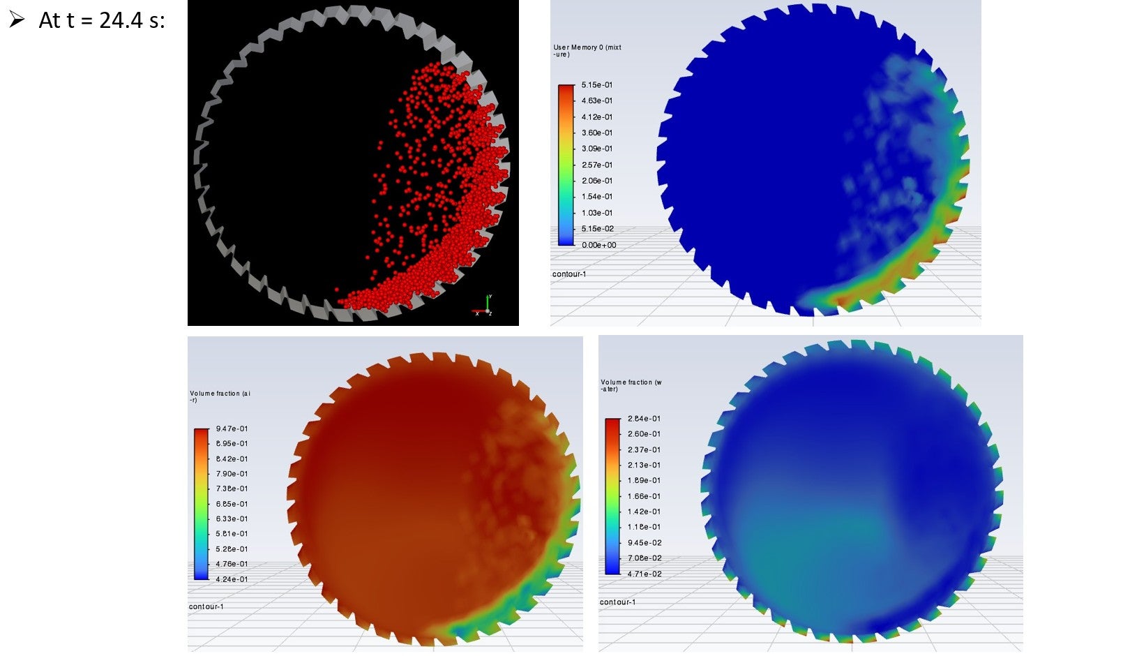

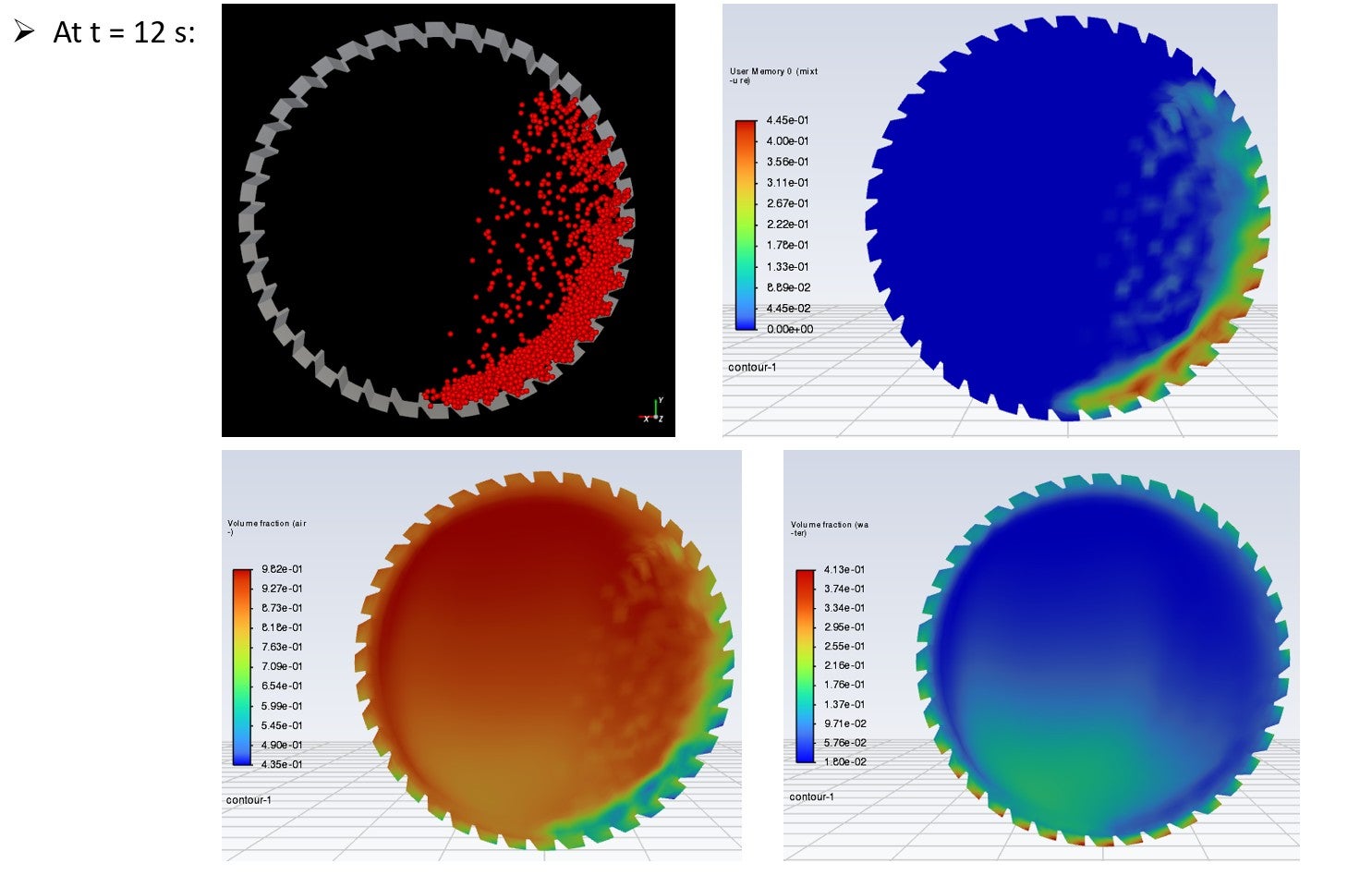

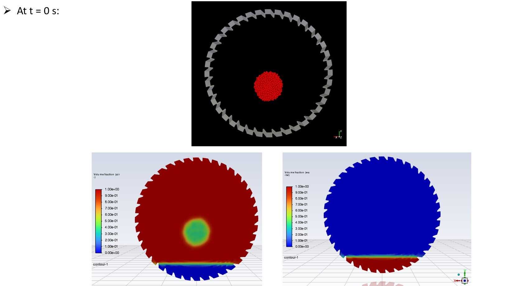

An issue in the liquid volume fraction is observed when coupling Rocky with Fluent 2025R2.
The liquid mass is conserved. Simulation parameters:
Fluid time step: 0.001 s
Particle time step: 0.0006 s
Particle diameter: 0.05 m
Entire domain and boundaries rotate
Results and mesh are attached below. Could you please advise on possible causes of this issue in the water volume fraction ?
