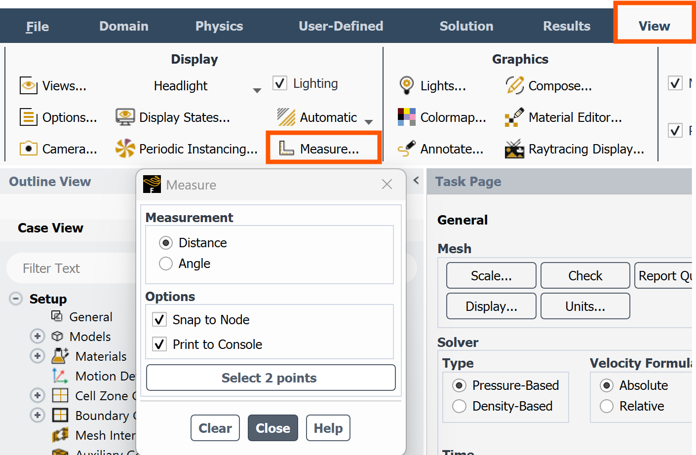

      Oh, I see. After you have run the simulations, just navigate to View > Display > Measure.

          I am using 2025 R2 version. Which version are you using? Did you run/initialize the simulation?

          I am using 2024R1 version.I run the simulation but there is still no measurement function.
    • Essence
      Could you try to install the latest versions of Fluent and try again?
      • 617283443
        Dear Essence!
        It can be concluded that this is caused by an older version of Fluent.
    • Essence
      Yes, I think so.
