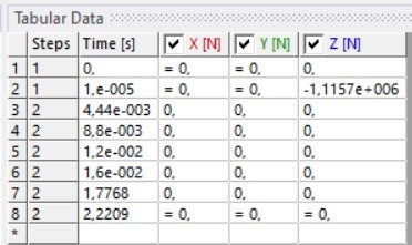

When I used Ansys Transient Structural (without water), I could set the Number of Steps = 2 (see first figure), which allowed me to apply a force for a very short time and then release it at step 2 to generate the free vibration oscillation. However, when I add the "Fluid Solid Interface" (with Number of Steps = 2) in Transient Structural, I see a question mark on this item (within the Ansys Transient Structural outline). This question mark disappears when I return to "Number of Steps = 1." When I try to apply the force and release it with "Number of Steps = 1" (see second figure), I don't get the free vibration oscillation (whether or not I've added the "Fluid Solid Interface").

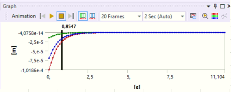

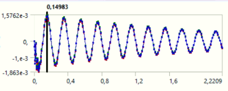

SubscriberThank you for your response. I'm interested in the graph of displacement vs. time of the turbine shaft in its longitudinal direction, after moving it longitudinally a distance and allowing it to oscillate (with the presence of practically static water, which only moves as a result of the turbine's movement under the applied force and without considering the rotation of the blades). I hope to obtain a curve that behaves similarly to the first graph attached below (which I obtained without the water with the first "Tabular Data" attached above) with the "directional deformation." However, when I define the force similar to the second "Tabular Data" attached above (Number of steps = 1), I obtain graphs similar to the one in the second image below (where there is no oscillation). Is it possible to generate this oscillation (whose amplitudes decay over time) of the shaft considering the effect of water in Ansys? How can I achieve this?
