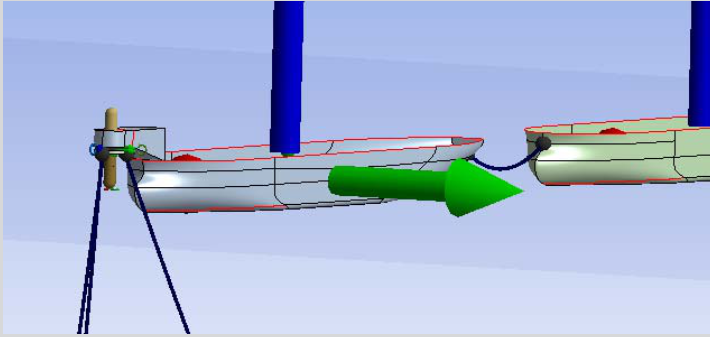

      hi,
      Please, I need urgent clarification.
      1) How are the structures simulated in tandem or side-by-side as shown in the pictures without one running into the other during the simulation time? This is not my own, but I tried a similar simulation, but as I increased the simulation time during time response analysis, I got an error, and one of the structures ran into the other.
      2) How is the articulation for the turret mooring system added as shown in this picture?
      I will appreciate it, if someone can make a video of this for me. I am completely lost.
      Thanks
    • Mike Pettit
      Aqwa doesn't automatically detect contact between structures, but you can create Fender connections to model any contact: https://ansyshelp.ansys.com/public/account/secured?returnurl=/Views/Secured/corp/v251/en/wb_aqwa/aqwa_fenders.html
      However, I guess the error you're encountering relates to the hydrodynamic interaction between the structures as they move relative to one another in the time domain. In the Hydrodynamic Diffraction analysis the Aqwa solver calculates how much of an effect the presence of one structure has on the motions of the other, and vice versa, due to shielding and wave radiation effects. This interaction effect is only calculated for the structures in their original positions, though, and it is not recalculated in the time domain as the structures move. So, the Aqwa solver stops if it detects that the relative motion is too large, as the results are likely to be inaccurate.
      For the articulation (joint) definition, please take a look at the user manual: https://ansyshelp.ansys.com/public/account/secured?returnurl=/Views/Secured/corp/v251/en/wb_aqwa/aqwa_joints.html

      I that case, how can i resolve this "HYDRODYNAMICALLY INTERACTING STRUCTURES HAVE MOVED SIGNIFICANTLY FROM THE ANALYSIS POSITION RESULTS ARE INACCURATE - MOVEMENT EXCEEDS 50%".
      I have tried everything i can but to no avail.
    • Mike Pettit
      The answer to this depends on the relative ship motions in the stability analysis (equilibrium position calculation) and/or the time response analysis.
      If the ships are moved relative to one another in the equilibrium position calculation, then you should use Part Transforms (right-click on each ship and Add > Part Transform) to move them closer to their equilibrium positions for the Hydrodynamic Diffraction analysis.
      For example: Ship 1 is originally positioned at X = 10 m, Ship 2 is originally positioned at X = 230 m. The equilibrium calculation moves the ships to X = 40 m and X = 190 m, respectively. Add a Part Transform to Ship 1 to move it +30 m in the X direction; similarly for Ship 2 to move it -40 m in the X direction. In this way the definition positions of the ships in the Hydrodynamic Diffraction analysis will be closer to their equilibrium positions, and you are less likely to see warnings related to hydrodynamic interaction in the time domain.
      If the ships move relative to one another in the time domain, this is harder to fix. The recommended approach is to create a separate Hydrodynamic Diffraction analysis for the ships in their transient positions, then use a Python pre-solve script to load the hydrodynamic database from this additional Hydrodynamic Diffraction system into a second time domain Hydrodynamic Response system.
      For example: Ship 1 is originally positioned at X = 10 m, Ship 2 is originally positioned at X = 230 m, and there is no change in relative position during the equilibrium position calculation. After 3600 seconds of the time response analysis, Ship 1 has moved to X = 40 m and Ship 2 to X = 190 m. To avoid inaccurate time domain results, a separate Hydrodynamic Diffraction analysis is defined, in which Part Transforms are used to move the ships to X = 40 m and X = 190 m respectively. A second time response analysis is linked to the first, with a Start Time of 3600 sec, and a pre-solve script is used to import the hydrodynamic database from the additional Hydrodynamic Diffraction analysis. In this way the hydrodynamic interaction effects are 'updated' for the new ship positions.

      I have a similar issue in ANSYS AQWA as the original post. I am also simulating two bodies in time domain which are moving away from each other. Since they are very close to each other at the beginning, the hydrodynamic interaction should be considered from my point of view. Nevertheless, they have to move away from each other leading to the ""HYDRODYNAMICALLY INTERACTING STRUCTURES HAVE MOVED SIGNIFICANTLY ..." issue.
      You wrote in your previous reply "The recommended approach is to create a separate Hydrodynamic Diffraction analysis for the ships in their transient positions, then use a Python pre-solve script to load the hydrodynamic database from this additional Hydrodynamic Diffraction system into a second time domain Hydrodynamic Response system."
      Can you give me some example on how such a pre-solve script needs to be establishedt?
      I have worked with pre- and post-solved python scripts before, but not with respect to his topic. I assume the workbench scheme should look like my quick example in the figure below? Using addtional diffraction modules with the same geometry, but moving the objects via part transform to an intermediate and final position (by assumption of two addtional positiones required for the time domain analysis). Additionally, connecting the multiple time domain modules to the equilibrium calculation module / to each other to perform the time domain analysis in three steps of 3600s each (to stick to your example above). Can you give me some hint on how a pre-solve script for this needs to be done? Can the "used hydrodynamic database" from the diffraction analysis be updated simply by changing some variable in which the path to the databases is stored (from the original database to one of the others).

      You have absolutely the right idea. In the time domain Aqwa input file, e.g. TimeResponse.dat, there's a reference in Deck 6 (FDR1) to the hydrodynamic database (HYD file) from the upstream Hydrodynamic Diffraction analysis. Your pre-solve script in each time domain system should change the HYD file path so that it consumes the database from the diffraction analysis for the structures in there shifted positions.
