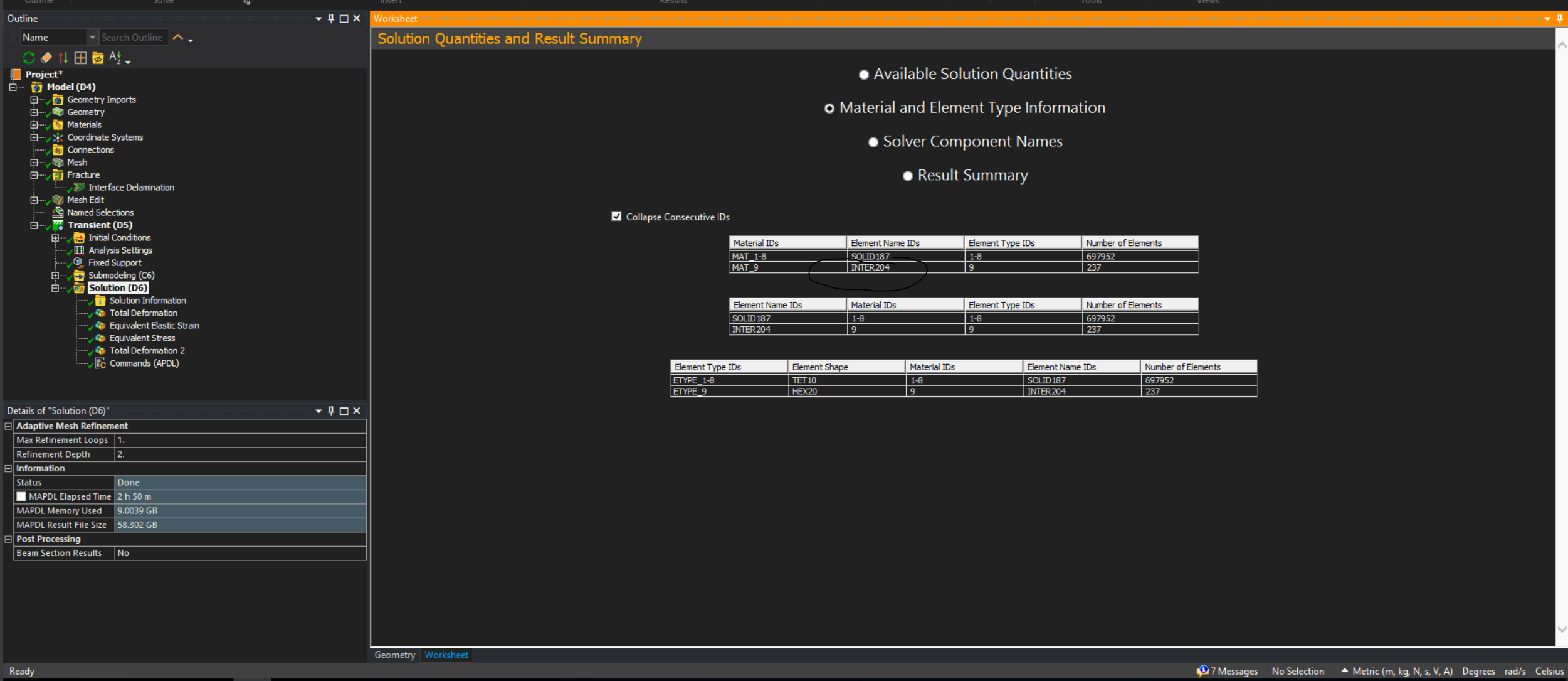

      I am trying to pull INTER204 Output Results from a CZM Interface Delamination Sub-model, but the Strain Energy Density results are not present in the solution quantity worksheet. I have issued the OUTRES,ALL,ALL command in the Solutions Tree, but the Solution Worksheet does not update with the desired information. I am using Ansys 2025 R1 and running the sub-model in a transient structural module.
      Is there something else I need to do to access this data?

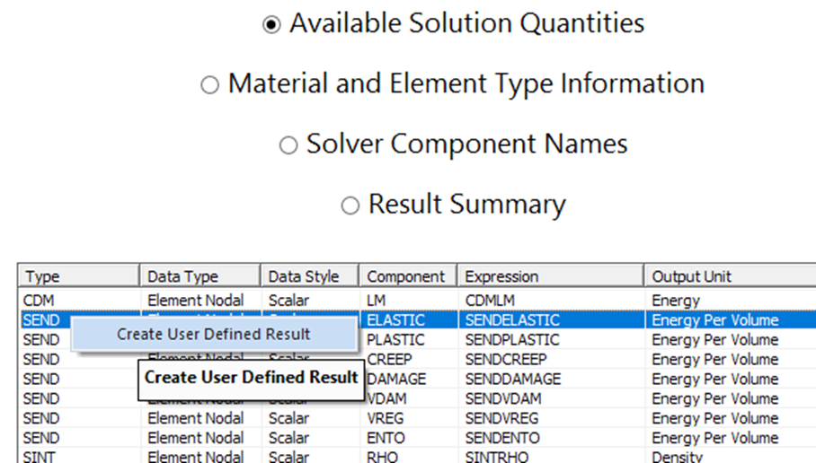

      Can you please tick the radio button called Available Solution Quantities (see below), in the result worksheet you are showing.
      Scroll through that to see if it is there as shown.

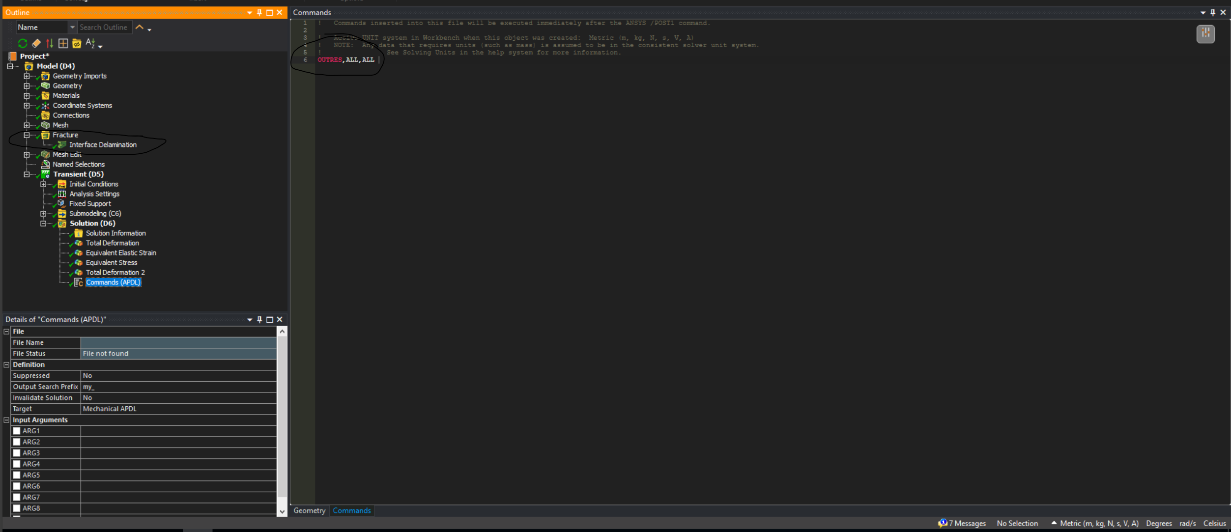

      Hey Joshua, one more thing — the OUTRES command is a solution command, so it needs to be placed under the analysis settings block (/SOLVE). Thanks, Deepak
    • jdo60
      Thanks for your help, I will try putting the command under the analysis settings block.
