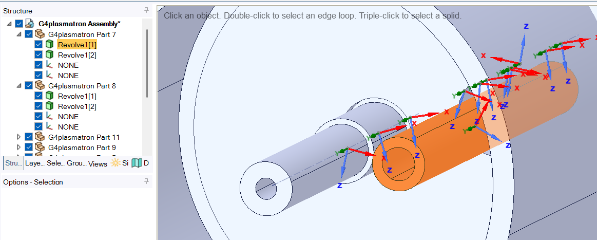

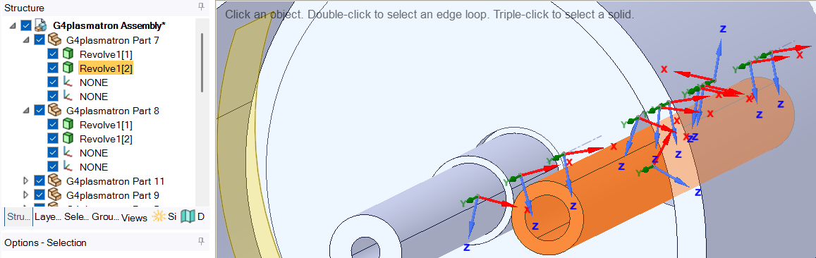

      I imported a Solidworks assembly as a .STEP file into a project on Workbench, and when I opened the geometry in SpaceClaim, I noticed that most parts had duplicates of the same feature.
      There are also all of these coordinate systems named "NONE", two in each part, and another duplicate in this folder:
      Does anyone have any idea why this happened? How do I fix this?
      Export a Parasolid file from SolidWorks and open that in SpaceClaim and see if you get a better result.
