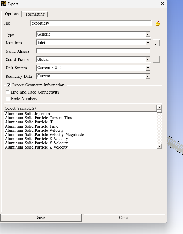

      Actually in the file>export>part history data, there is no option to choose the particle positions as variable but there are other variables available to select. So, is there a method I can save the particle positions every time step in a seperate file and update the file continously? The .dat file has all the variables but too costly to save at every time step. Also I want to plot the dispersio func (which depends on part positions) with time which should be a continous graph-so need to save at every time step.
      I think the positions are included automatically? Did you try it to see?

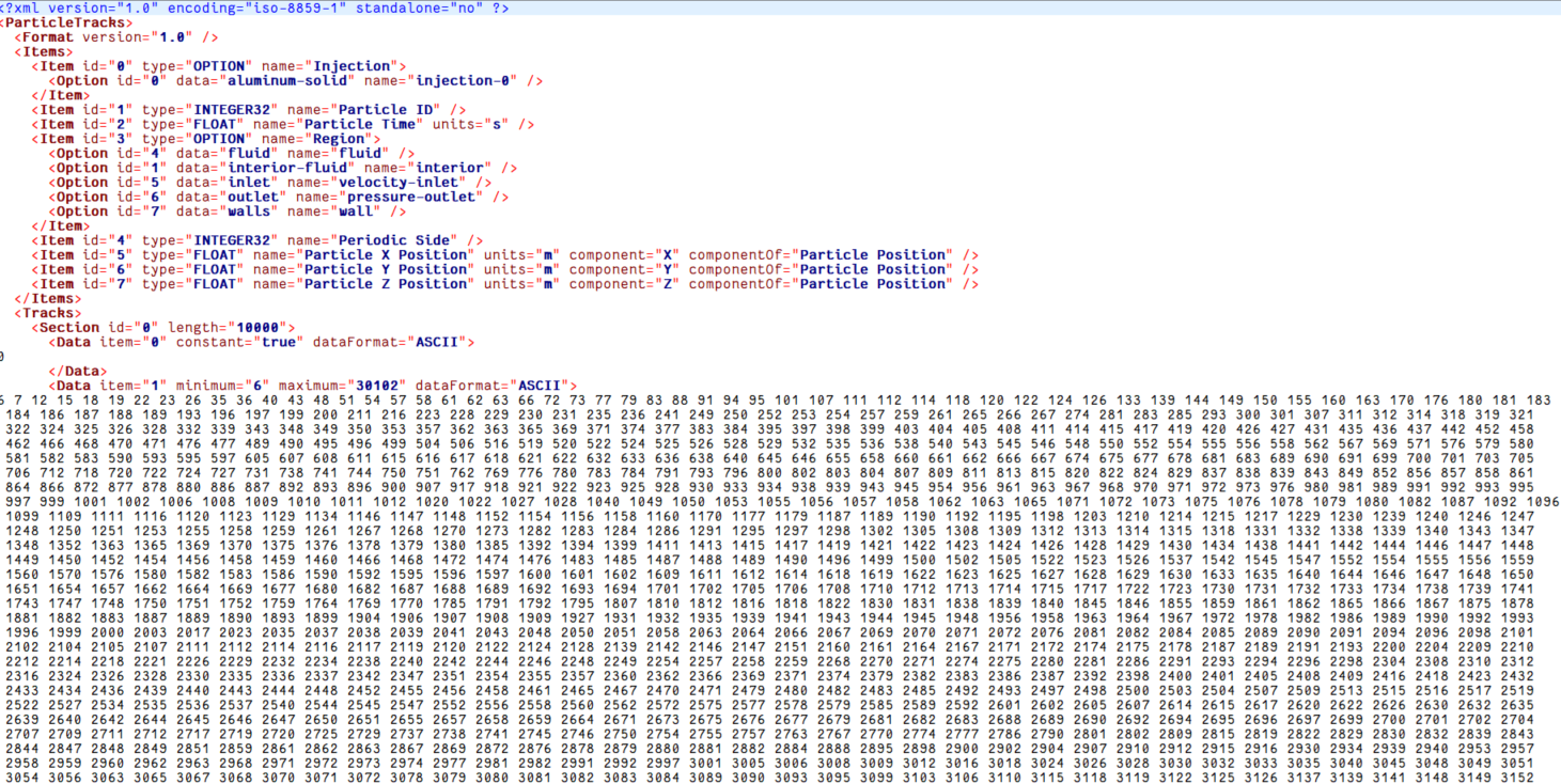

      Hi. I have exported the part hist file in CFD-Post format. When i open the part hist.xml file in CFDPost, it does not show particle position variables. Please see attached screenshot. When i scroll down there are no variables for particle positions, therefore i think they cannot be exported in the part hist file. Do I have to export it in some other format?
      Open the file you saved in a text editor - why would the export contain field variables but not position?

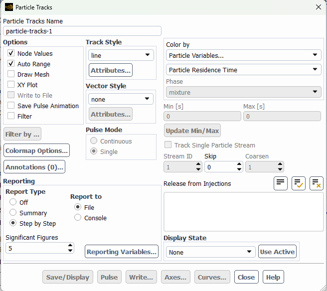

      Or use Fluent's DPM Reporting
    • aniruddhabose96
      DPM reporting is fine but if I want the positions every time step, then i cant manually open the reporting every time. For that I need to save the file in the directory.
      Please rephrase. If you run the equivalent report as an Execute Command it should dump the data out into a file.

      Hi After I open the .xml file using a text editor it is showing the following picture:Here it is very confusing to know which data indicates particle position and which data indicates time. Also there are some Ascii things written if i scroll down so very confusing to clearly understand this file. Any suggestions?
      Compare blocks of text with what you know. Ie is it a block of IDs, then something else?

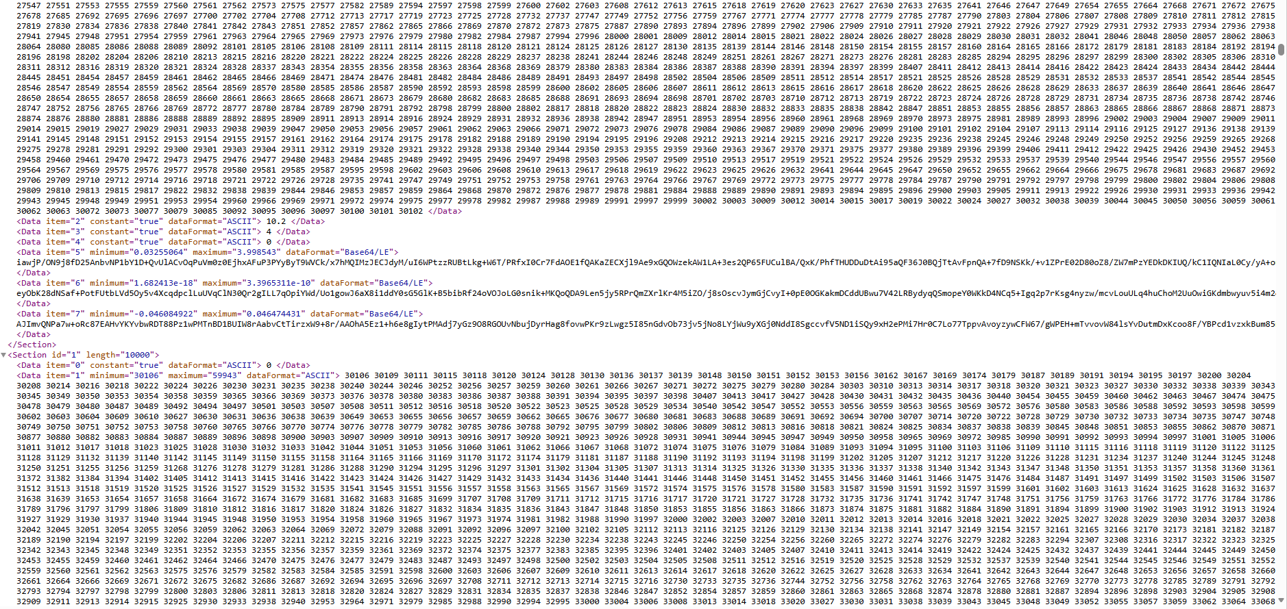

    • aniruddhabose96
      Hi-Still it is not quite understable as X position etc should be in decimal right? but i am seeing everything as integer in this text file.
      What does the rest of the file look like?
    • aniruddhabose96
      It contains only integer values in large blocks and some headings in between like thisIs it not possible to only save variables of interest in a text file seperately like one does in in-house codes?
      Yes, which are then interpreted into the next Ansys package. Yes it is possible, have a look at the other format options, failing that it's a UDF or some additional work on whatever output you get or on the data sets.
