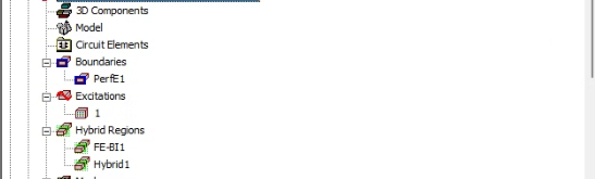

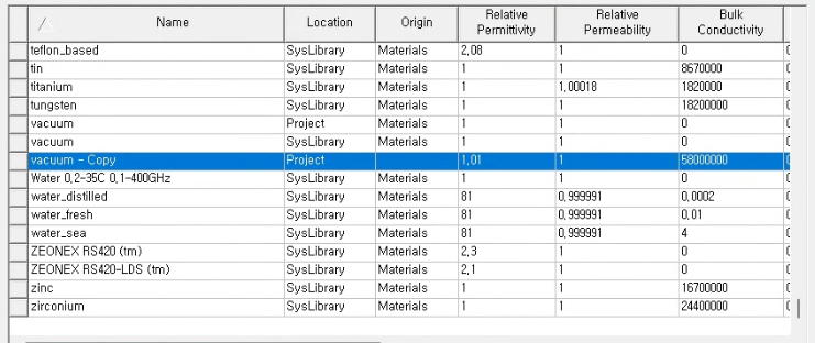

I am currently simulating a Horn Antenna and a Metal Sphere(2.5m Distance) using Hybrid Solver(FE-BI & IE). My goal is to analyze the Target Reflection Signal (S11) by performing Background Subtraction.The Problem: To accurately subtract the background noise from the S11 data, I need to keep the mesh identical between the "Target" (Sphere present) and "Background" (Sphere absent) simulations using Mesh Import. However, changing the sphere's material (e.g., from PEC/IE to Vacuum) forces a re-mesh, causing the Mesh Import to fail.
Attempts:
Virtual Material: Used a "virtual material" (permittivity=1.01) instead of Vacuum to trick the solver into maintaining the mesh structure.
Configurations: Tested Pure FE-BI, Hybrid FEM+IE, and Dual FE-BI setups.
Tuning: Reduced Delta S and increased mesh density for higher accuracy.
Current Result:
The background noise is subtracted, but the peak level of the subtracted S11 signal (Time Domain) is significantly lower (-80dB) compared to the measurement data (-50dB).
Questions:
Is using a "Virtual Material" a valid workaround to force Mesh Import for S11 subtraction in a Hybrid Solver setup?
How can I strictly "freeze" the mesh when the target object (IE Region or PEC) is removed for the background simulation?

SubscriberI have attached three additional images to better illustrate my simulation setup and material settings.
- Geometry View (Horn Antenna & Sphere)
2.Setup Tree (Hybrid Regions & Boundaries)
3. Material Settings (Virtual Material with permittivity = 1.01)
I apologize for posting these as a comment (reply). I was unable to create a new post due to a system issue, so I am sharing the supplementary information here instead.
I look forward to your response. Thank you!

Ansys Employee> 1. Is using a "Virtual Material" a valid workaround to force Mesh Import for S11 subtraction in a Hybrid Solver setup?I have no experience with such analysis cases, so I don't know if it's an effective workaround.> 2. How can I strictly "freeze" the mesh when the target object (IE Region or PEC) is removed for the background simulation?Are you trying to import a mesh by checking Import Mesh on the Advanced tab of Setup?If so, select Ignore mesh operations in target design under Additional mesh refinements in Setup Link,and set Maximum Number of Passes to 0 on the General tab of Setup and Minimum Number of Passes to 0 on the Adaptive Options tab to avoid additional mesh generation. -

SubscriberIn addition to my inquiry above, I am attaching supplementary images to better illustrate the issue.
1. TDR Comparison (Simulation vs. Measurement):
As shown in the graph, the peak level of the simulation result (after background subtraction) is approximately -80dB, whereas the actual measurement data shows a peak of -50dB.
2. Simulation Setup & Material Details:
I have also attached screenshots of my current Hybrid setup and the ‘Virtual Material’ settings used for the Mesh Import workaround.
I hope these materials help clarify my situation. I look forward to your advice.

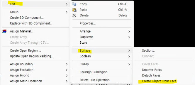

February 2, 2026 at 3:04 am
gyummine
SubscriberDear Mr. Itadani,
Thank you for your guidance.
Following your advice, I set the Maximum Number of Passes to 0 and enabled Ignore mesh operations in the target design, as shown in the attached image. I then attempted to change the sphere’s material to Vacuum for the background simulation.
However, assigning Vacuum to the IE Region resulted in a critical error, which you can see in image below. The error message states: A dielectric IE region of the same material as global material environment is not allowed. This confirms that HFSS prevents creating a Volume IE Region if it shares the same material as the background.
Since the volume approach failed, I am considering a surface-based method. As shown in image below, I can use operations like Create Object From Face to extract the outer skin of the sphere.
My question is: If I replace the solid sphere with a sheet object (a surface with no thickness) in the Background simulation, can I successfully import the mesh from the Target simulation? My goal is to use this sheet strictly to maintain the mesh topology without it affecting the electromagnetic fields.
Is this surface-based approach a valid alternative to using a virtual material?
I look forward to your clever insights!
February 2, 2026 at 4:09 am
Takeshi Itadani
Ansys EmployeeIf you change the object, the Import Mesh function will no longer be available.
Try assigning air instead of vacuum. If you still get the same error, it may help to assign a material with a slightly different Relative Permittivity. -
