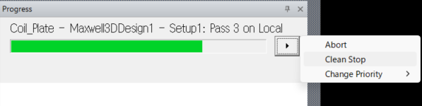

      does anyone know how to interrupt an AEDT Icepak run during iterations without losing the solution(iteration) progress?
    • Takeshi Itadani
      You can safely interrupt the analysis by clicking the button on the right side of the Progress window and selecting Clean Stop. The analysis status up to that point is saved, so when you run the analysis again, it will continue from where it was stopped by Clean Stop.
      If the Progress window is not displayed, select Menu > View > Progress and check the box.
