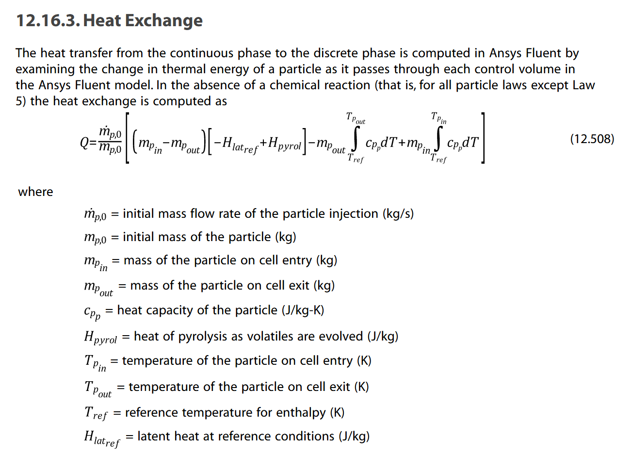

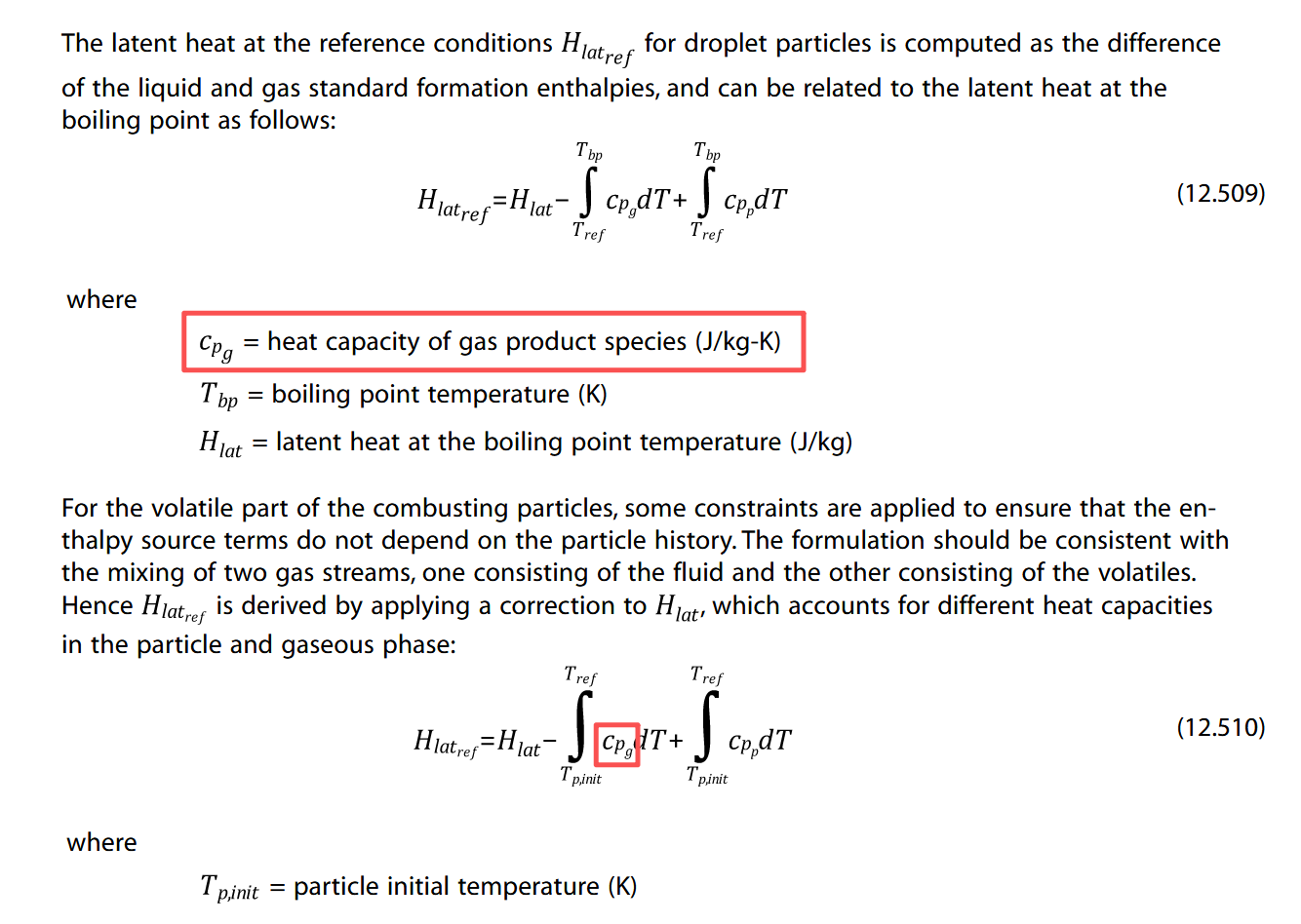

    • hefeinanzhan
      In the process of writing a source term UDF for volatile particles and the continuous phase, I encountered this issue. Currently, the mass source term is completely consistent with Fluent's default calculation, but there's always some discrepancy in the energy source term. When calculating the energy source term, does the variable C_pg in Equation 12.510 represent the specific heat capacity of the volatiles?

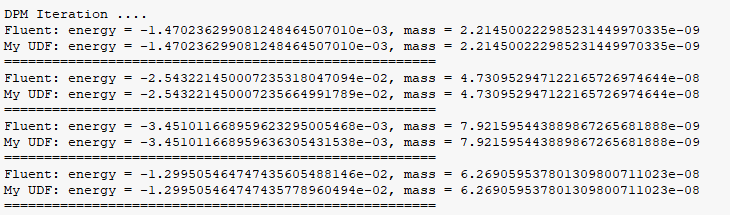

    • hefeinanzhan
      In the test case, I set the specific heat of the volatiles to 2500. Below are the output results and my UDF source code:
      DEFINE_DPM_SOURCE(dpm_source, c, t, S, strength, tp)
          if (TP_CURRENT_LAW(tp) == DPM_LAW_DEVOLATILIZATION)
              if (tp->part_id == 0)
                  real cp_g = 2400;
                  real H_lat_ref = strength * (TP_MASS0(tp) - TP_MASS(tp)) * (cp_g * (T_REF - TP_INIT_TEMP(tp)) - tp->Cp * (T_REF - TP_INIT_TEMP(tp)));
                  real Q_in = TP_MASS0(tp) * (TP_T0(tp) - T_REF) * tp->Cp;
                  real Q_out = TP_MASS(tp) * (TP_T(tp) - T_REF) * tp->Cp;
                  real Q = strength * (Q_in - Q_out);
                  real Q_cal = Q - H_lat_ref;
                  real M_cal = (TP_MASS0(tp) - TP_MASS(tp)) * strength;
                  printf("Fluent: energy = %.24e, mass = %.24e\n", S->energy, S->species[0]);
                  printf("My UDF: energy = %.24e, mass = %.24e\n", Q_cal, M_cal);
                  printf("======================================================\n");
                  fflush(stdout);
