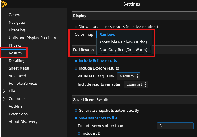

      There is no way to change the color of the out of range results. That is shown in light theme to recognize the difference.
      You do have option to change the color map of the results legend from settings > results as shown below in 2026 R1:
      Devendra
