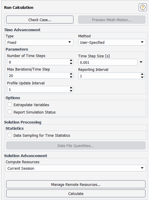

aniruddhabose96
SubscriberYes, I switched on everything and ran for 4.8 s for time averaging. The variables i get in the contour panel are Mean X velocity, RMSE X velocity but do not get RMS X velocity.
