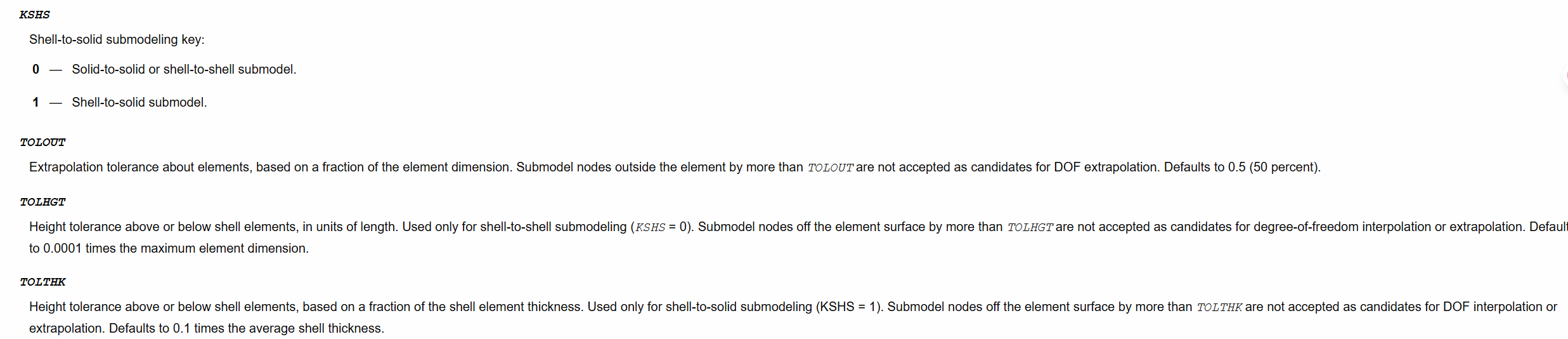

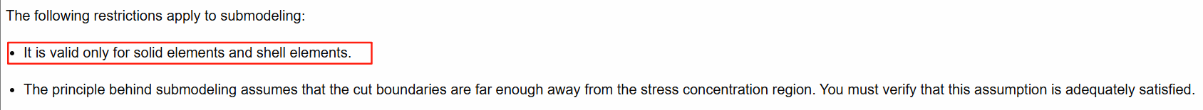

      • 2020221038
        Thank you for your response. In the help, the CBDOF command only introduces shell-shell, shell-solid, and solid-solid submodels, and does not introduce beam-to-solid submodels. I have also consulted some literature. ANSYS submodels can only be used for shells and solids, and there is no mention of their use for beam elements in APDL.

      • 2020221038
