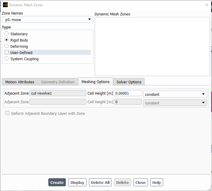

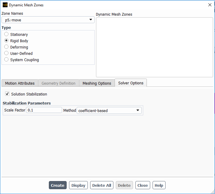

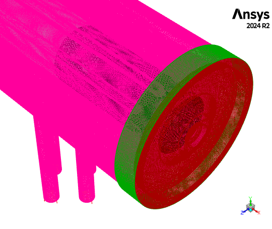

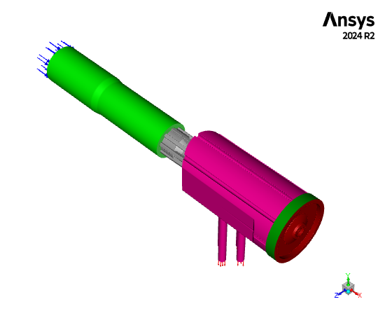

      The mesh is built in unstructured, polyhedral cells. The motion region is the marked in red, whose movement translates 1mm in 1 second, negatively in X axis. The movement is controlled by a .prof motion profile. The Dynamic Mesh settings are found below.

      It seems like your figures made it as links to your post. Forum policy reasons does not allow me to click on those links. See if you can post them again.
      However, based on your response, I can say that polyhedral cells are not supported for Remeshing. So if they are part of the zones requiring remeshing, this will not work. As per my previous response, you will need to have tetrahedral cells in these regions.

      Thank you, here are the images.

      Regarding the polyhedral mesh, I truly don't know if this is the reason leading to the referred error, since all the meshes I have tried use 100% polyhedra, and the failure in remeshing would only happen for the ones containing Boundary Layers.
