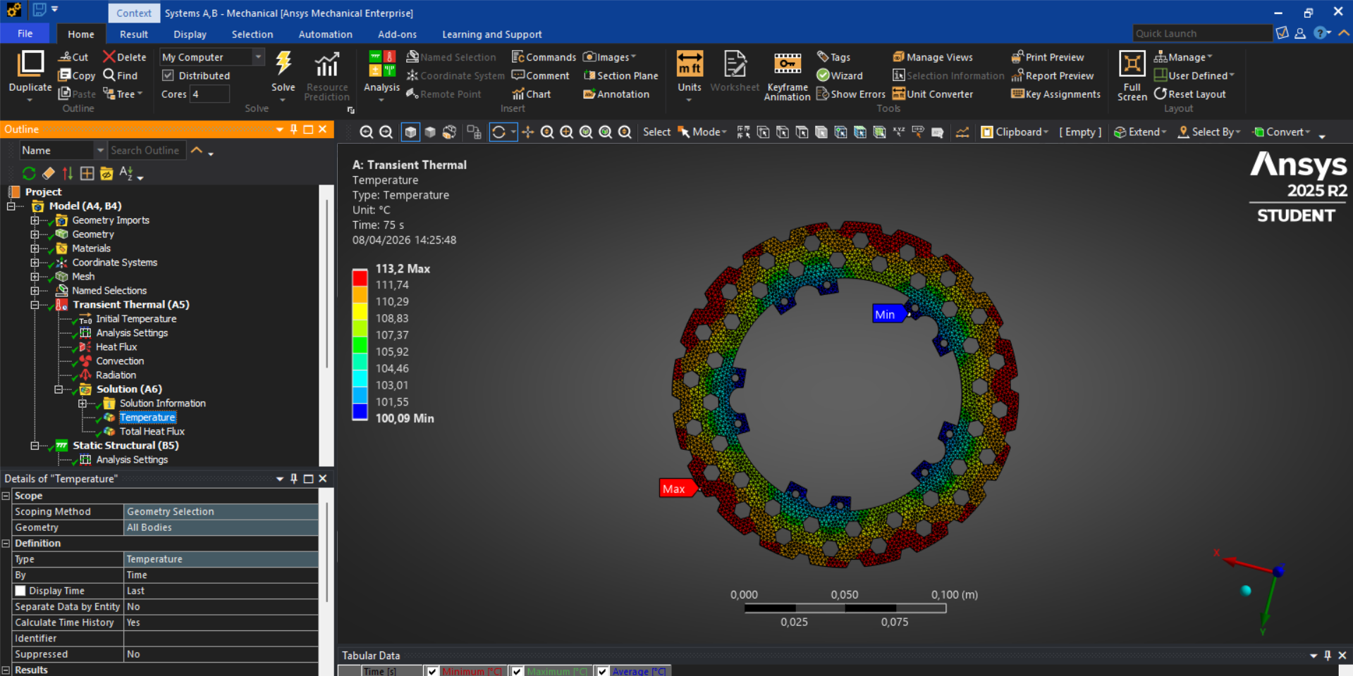

SubscriberHere i made a thermal analysis for the new brake disc for the Formula UFSM FSAE team.

SubscriberThat's interesting. Did you check the Heat Balance on the model to see if the sum of output Reactions from Convection and Radiation Boundary Conditions balance the Heat Flux input?
