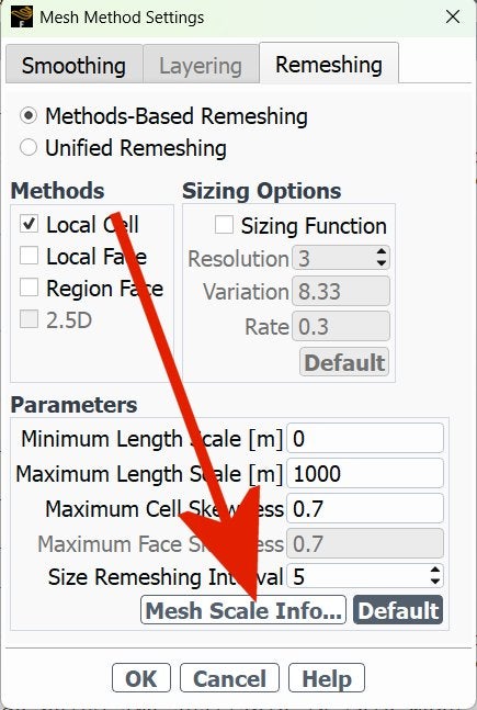

Ansys EmployeeHello Alexandre,Â
unfortunately, there is no such TUI command to access those values. What are you looking to do? Perhaps we can suggest some alternatives.
For a full list of TUI commands associated with Dynamic Mesh, you can look through the Fluent Text Command List Chapter 2: define/
June 4, 2026 at 5:02 pm
ALEXANDRE COSTA
SubscriberThanks for the output. A want to calculate lenght-min lenght-max automatically and use in a journal for dynamic mesh setup
