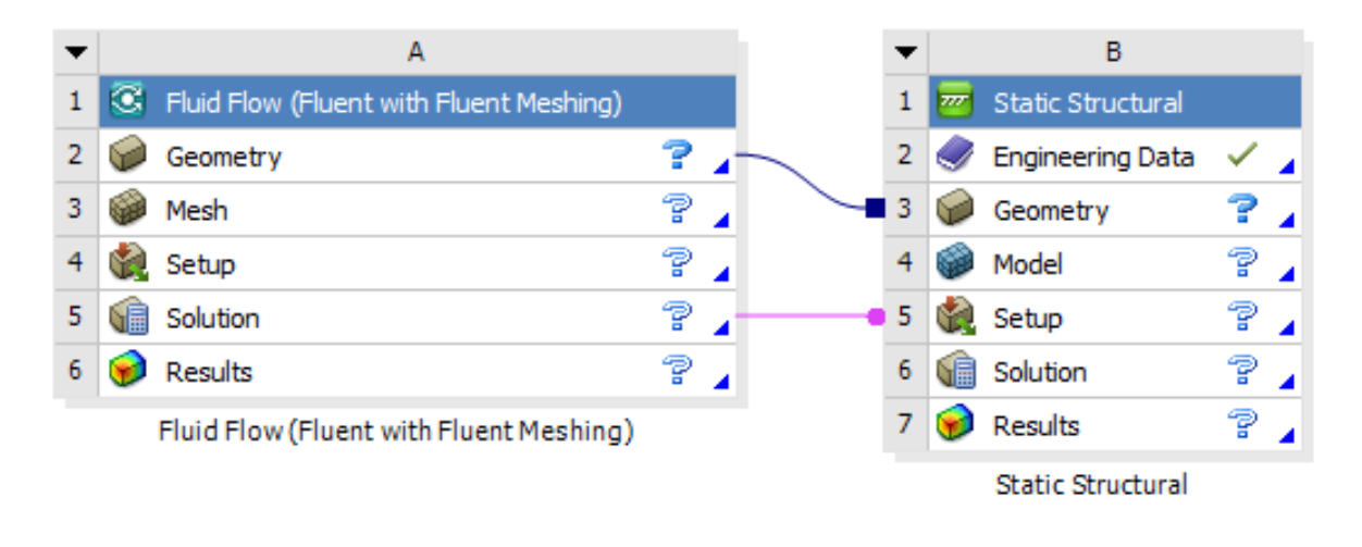

      Can you import fluent case (fluid mesh generated using Fluent Meshing) and data file to Ansys Mechanical for transfering pressure loads to structures?
    • Rahul
      You can import the the data in Mechanical with direct schematic connection in workbench.
      Please refer to Using Imported Loads for One-Way FSI
