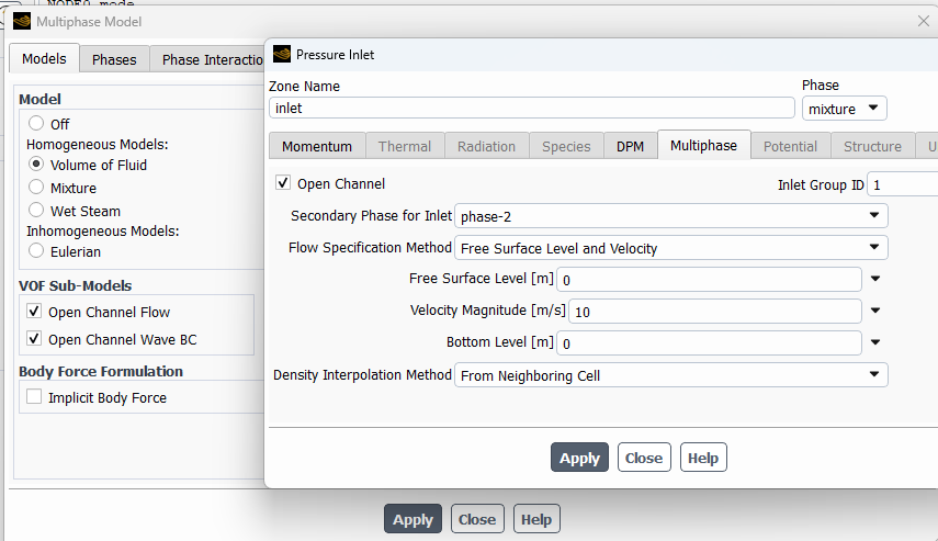

      If you turn on the open channel options you should be able to set height and speed as a function of time.
      Alternatively there are various wave models in the code.
