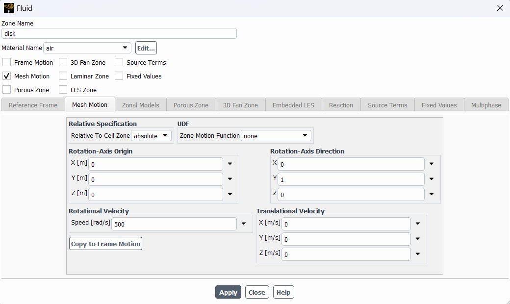

      Hello everyone,
      I'm trying to use Ansys Fluent to examine the effect of increasing angular velocity on thrust for a project. I would like to calculate the thrust force generated. I have a medium and a disk with a propeller inside. How would I do so? I'm brand new to Ansys.
      Thanks in advanc
