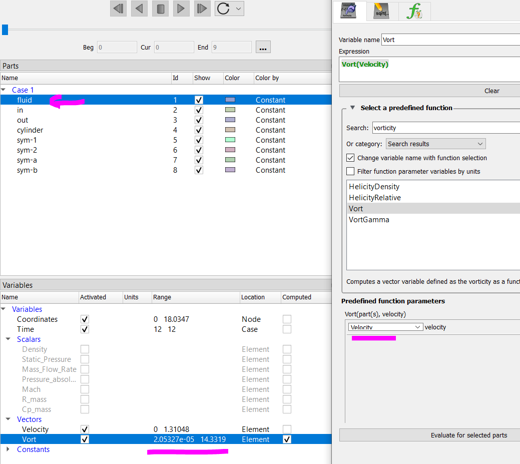

    • Anilkumar Sardesai
      You may not get the vorticity vector transferred from Fluent to EnSight. You can use EnSight's calculator to compute the Vorticity.
      You may refer to EnSight help document below for further details.
      8.5. Variable Creation
      8.5.2.146. Vorticity
      Anil
