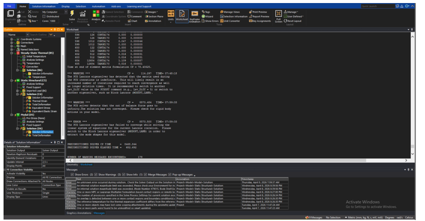

        I performed the modal analysis, yet it just cant get the result:
         *** WARNING ***                         CP =     114.297   TIME= 07:48:18
         The PCG Lanczos eigensolver has detected that the matrix used during
         the PCG iterations is indefinite.  This will likely result in an
         increased number of iterations required to reach convergence as well
         as longer solution times.  It is recommended to switch to another
         Lev_Diff value on the PCGOPT command (e.g., Lev_Diff = 5) or switch to
         another eigensolver, such as Block Lanczos (MODOPT,LANB).
         *** WARNING ***                         CP =    8573.484   TIME= 07:59:33
         The PCG solver detects that the out of balance force goes to
         infinity.The solution has not converged.  Please check for rigid body
         motions in your model.
         *** ERROR ***                           CP =    8573.500   TIME= 07:59:33
         The PCG Lanczos eigensolver has failed to converge while solving the
         linear system of equations for the current Lanczos iteration.  Please
         switch to the Block Lanczos eigensolver (MODOPT,LANB) in order to
         extract the mode shapes for this model.

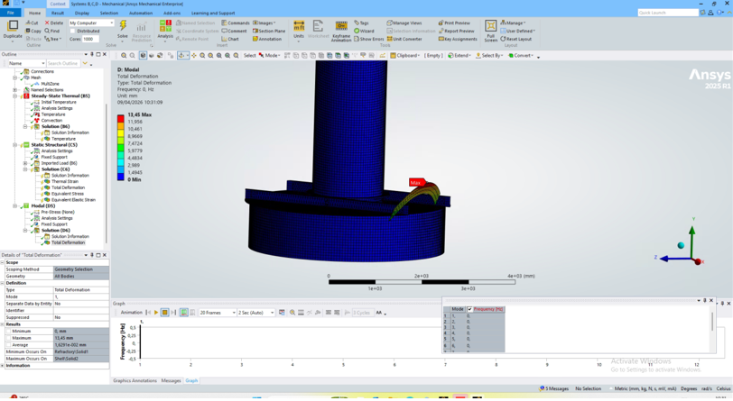

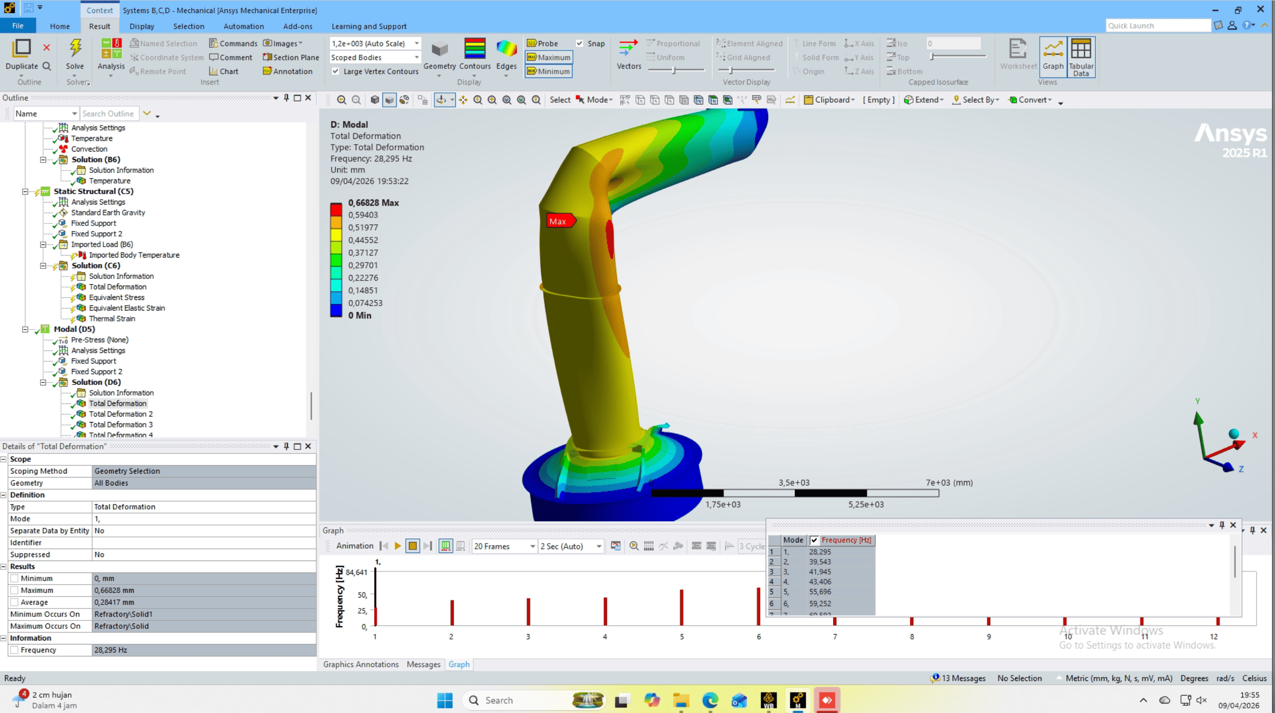

      • marshal.andreas.pub
        this is the modal analysis with contact on :
      The small text in the screen snapshots is nearly illegible. The software you are using to take them is reducing the screen image resolution. Windows comes with Snipping Tool which does not reduce screen resolution at all. Try using that to paste images into your replies.
      If that last image is for Mode 1, the frequency is now non-zero which is required for Static Structural to solve without an error. When you animate that result, does the part with the Maximum deformation move in a way that shows it is connected to other parts in a sensible manner?  What do you mean by "with contact on"?
      In the second last image, the frequency is zero so that would mean Static Structural will give an error. The corrective action is to attach that part to whatever that part is supposed to be attached to. A part that floats that is meant to be fixed to ground should have a Fixed Support but if the part that floats is meant to be attached to other parts, then you need Bonded Contact to connect it to other parts so it doesnt float.

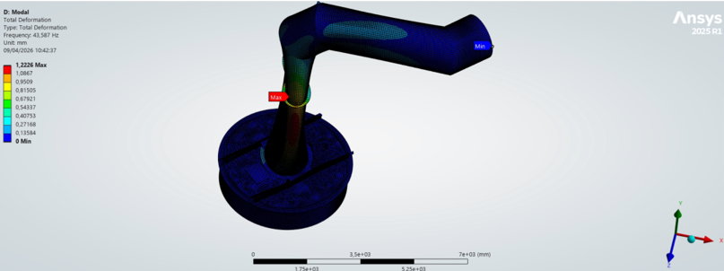

        Here is the modal analysis
        I don't use shared topology due to easier hexahedral meshing and I use automatic contacts (it works wonder for my steady state thermal)
        As u can see, there is no floating part and the part that have maximum deformation still moves in sensible manner

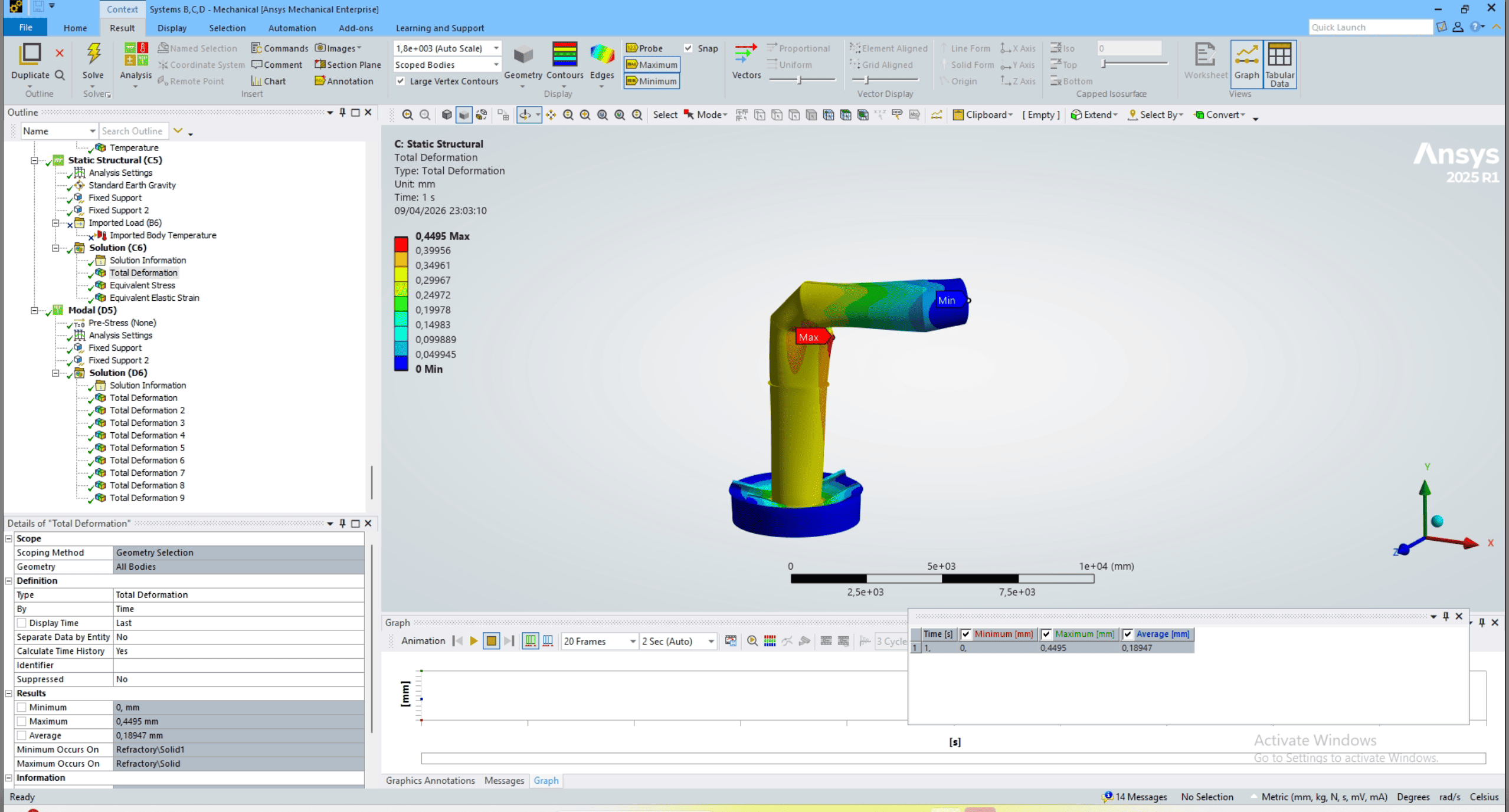

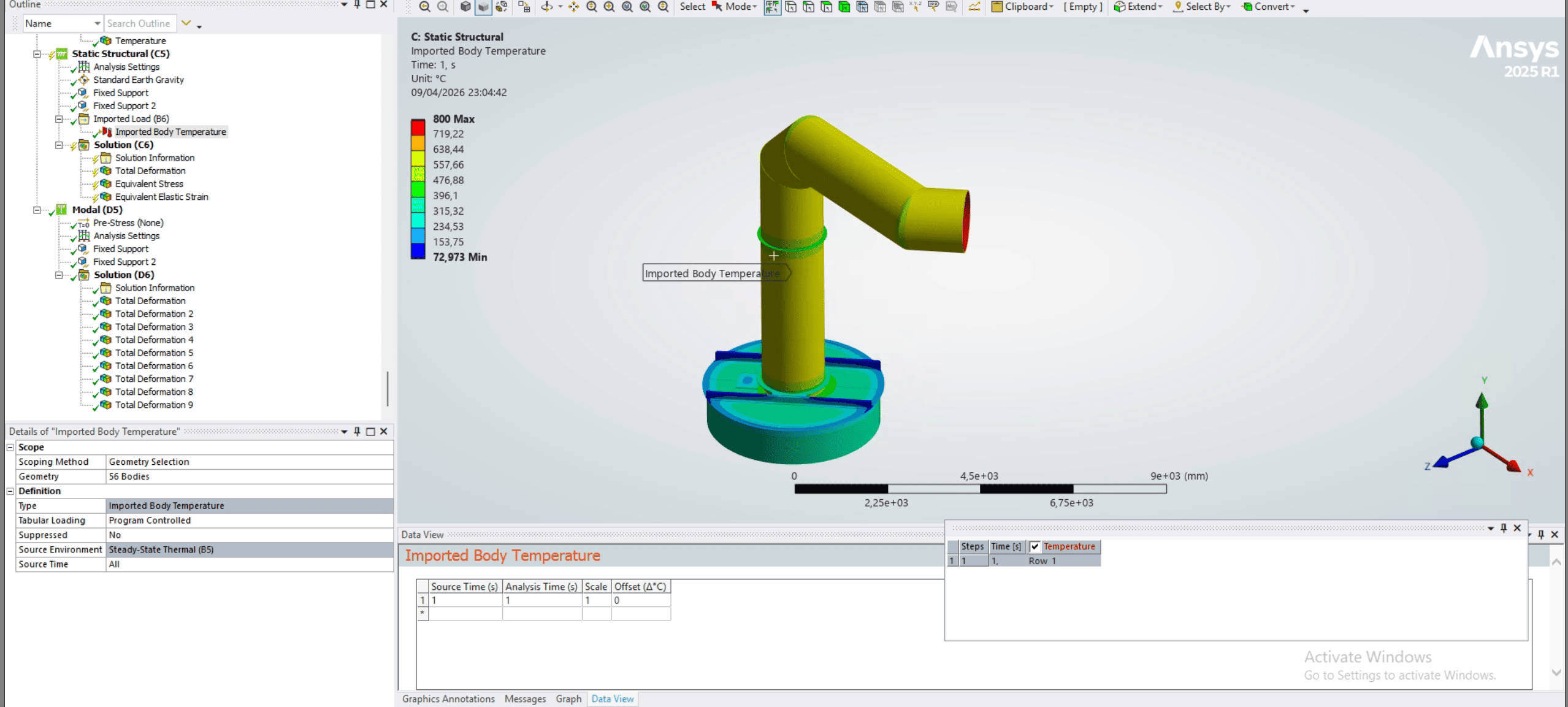

        The problem is when i only import the load temperature on static structural, but when i leave the static structural with gravity only, it works

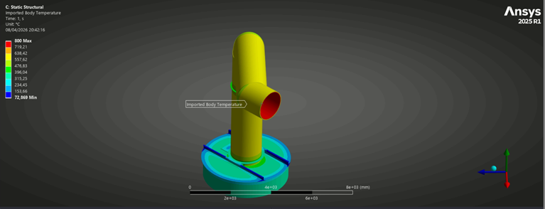

      Now that you have a Static Structural model that solves with a gravity load only, show that deformation result.
      When you add an Imported Temperature load you get an error, show that error, plot the Imported Load temperature and the Details window.

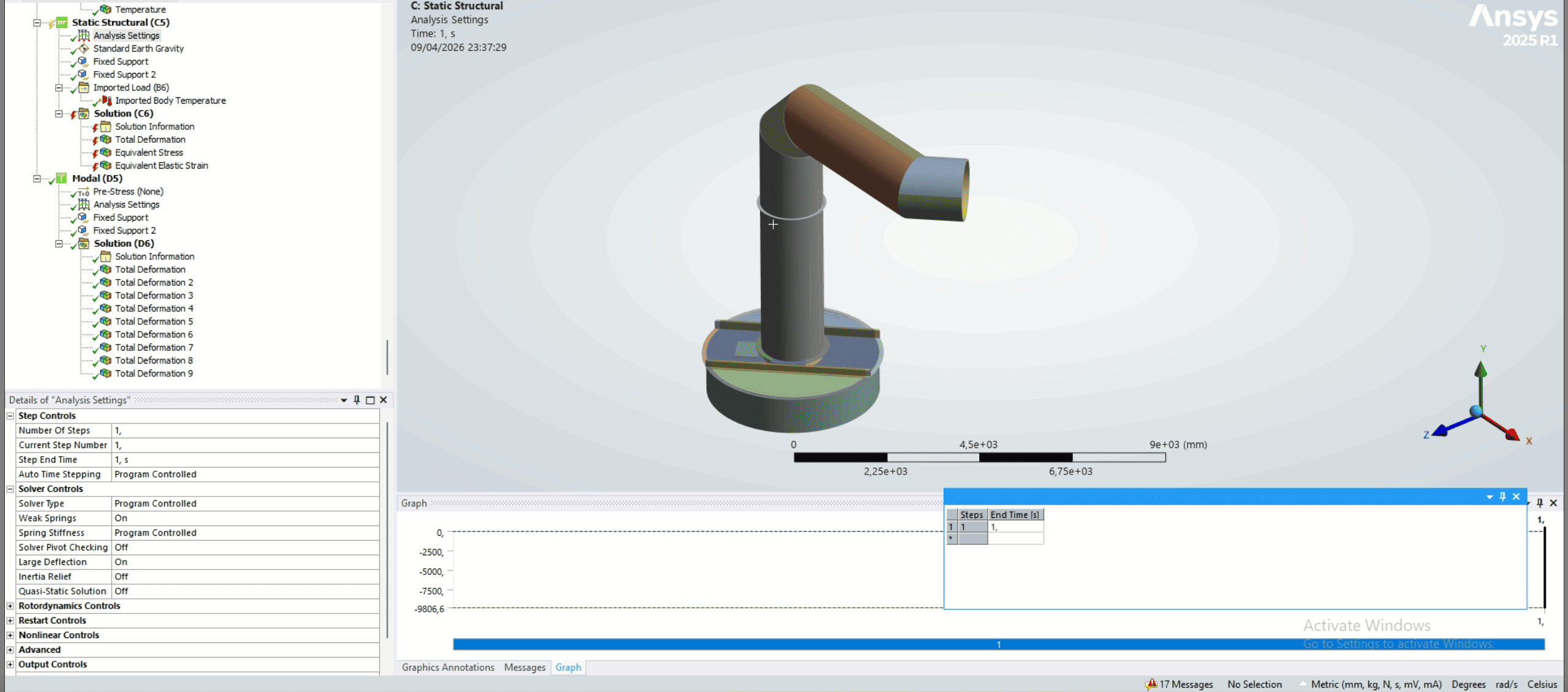

      Under Analysis Settings, try turning on Large Deflection, does that change the error?
      What is the Coefficient of Thermal Expansion value for each material used?
        No Large Deflection:
         *** NOTE ***                            CP =    4225.578   TIME= 23:11:31
         The Sparse Matrix Solver is currently running in the in-core memory
         mode.  This memory mode uses the most amount of memory in order to
         avoid using the hard drive as much as possible, which most often
         results in the fastest solution time.  This mode is recommended if
         enough physical memory is present to accommodate all of the solver
         data.
         Sparse solver maximum pivot= 2.911567527E+21 at node 129856 UY.
         Sparse solver minimum pivot= -1.831809152E+21 at node 126907 UY.
         Sparse solver minimum pivot in absolute value= 2485.20108 at node
         231642 UY.
         *** ERROR ***                           CP =    4297.906   TIME= 23:12:05
         The value of UY at node 238523 is 287245902.  It is greater than the
         current limit of 1000000 (which can be reset on the NCNV command).
         This generally indicates rigid body motion as a result of an
         unconstrained model.  Verify that your model is properly constrained.
         *** MESSAGE CONTINUATION ---- DIAGNOSTIC INFORMATION ***
         If one or more parts of the model are held together only by contact
         verify that the contact surfaces are closed.  Also make sure that
         there are constraints (or friction) in the sliding direction even if
         no load is applied in that direction.  You can use the CNCHECK command
         to check the initial contact status in the SOLUTION module.
        After Large Deflection:
