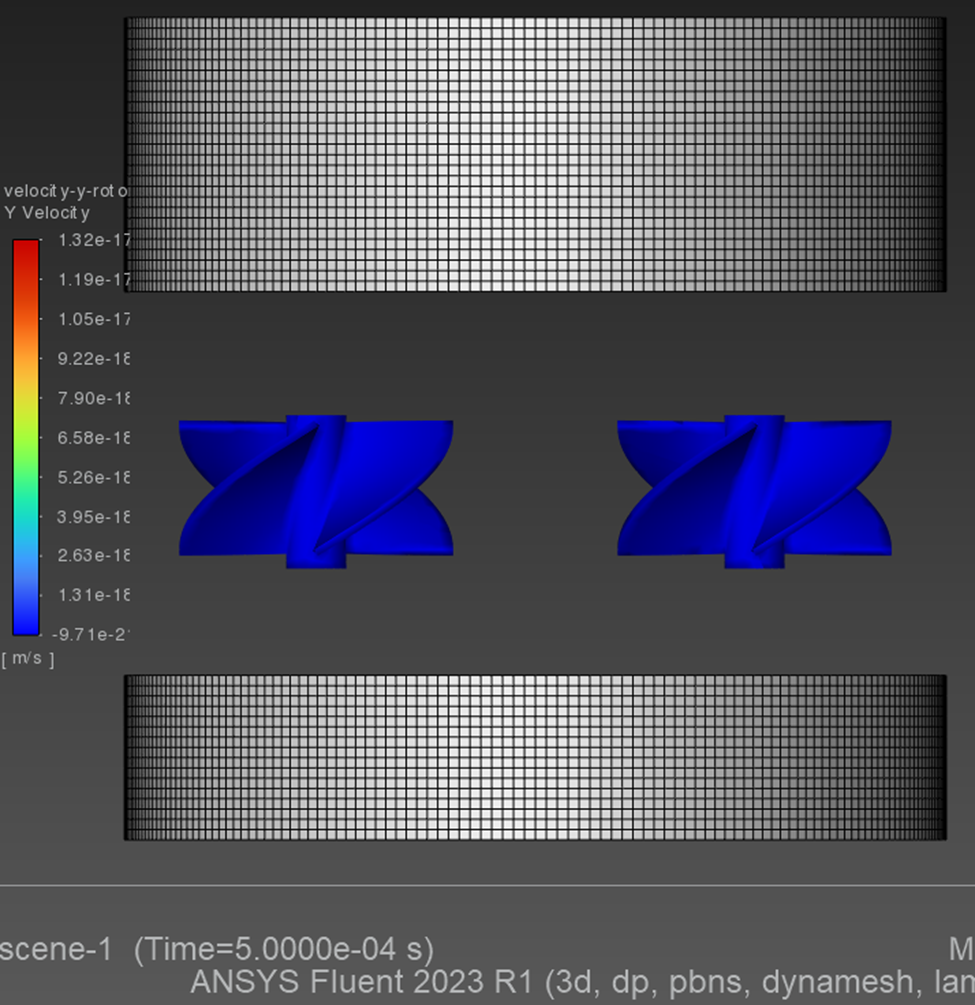

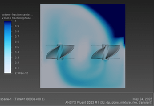

A simpler version of the problem with only rotational propeller movement is working using the Sliding Mesh method. In the image below, some artifacts at the interface between the rotating zone around the propeller and the static zone of the tank can be seen. This was a coarse mesh to establish that the mesh motion was working. Any suggestions about that artifact are welcome but that could be addressed separately in a different discussion.

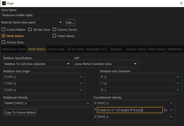

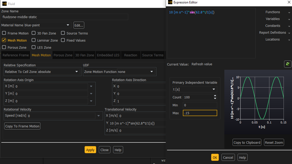

Mesh Motion has been defined on the middle-static zone and an expression causes the middle static zone to translate along the Y axis.

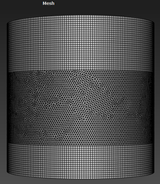

Here is the initial mesh.
Here is the mesh at a later time step.
Top and bottom tanks zones are deforming, and the propellers are moving up with the middle zone. Notice the compressed thickness of the bottom row of the top and the stretched thickness of the top row of the bottom. The next time step results in a negative cell volume error. Dynamic Mesh was edited to try Smoothing and Remeshing but the negative cell volume error persisted.

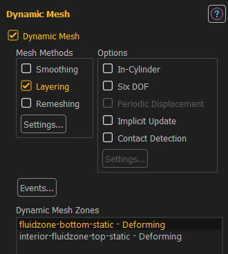

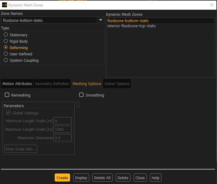

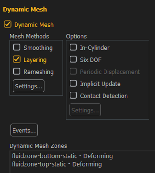

I created two Dynamic Mesh Zones, one for the top and one for the bottom fluid zone and chose Layering only.
When I click on the Settings for Mesh Methods, I see the Layering constants.
Below is the dialog to set up one of the dynamic mesh zones. There is no Layering Option.

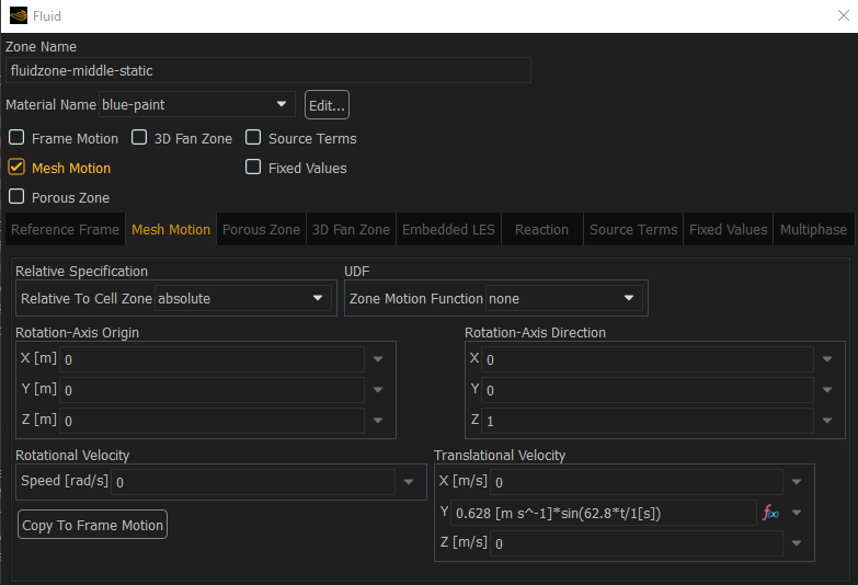

In my example, I want the top and bottom zones to deform because the middle zone has a Mesh Motion cell condition. So the face shared between the middle zone and the top or bottom zone is moved by the adjacent zone moving. Below is the Mesh Motion setting on the middle zone.

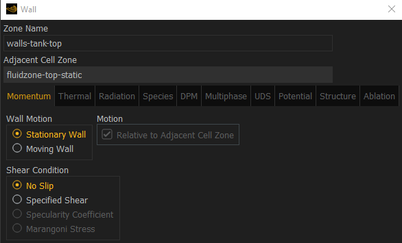

You said “set the top and bottom boundaries as Stationary”. Here are the Wall Boundary Conditions I currently have.
The walls-tank-top is composed of two surfaces: a cylidrical surface and a flat circular top surface. That is currently set to Stationary Wall.
You are suggesting that this should be separated into two wall boundary conditions so the top face can be left as stationary, but the cylindrical face, would that be defined as a Moving Wall?
Same goes for the walls-tank-bottom boundary.

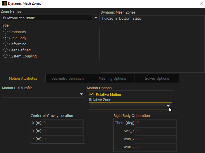

The motion of the middle zone follows a sine expression. When I add a Dynamic Mesh Zone for the fluidzone-top-static and set it to Rigid Body, there is a box for Relative Motion, but it does not allow me to see any zones in the pull down.
I don’t have a Motion UDF/Profile because I used an expression directly in the Translational Velocity Y component for the middle zone condition.

Ansys EmployeeEach layering cell zone should be set as Rigid Body Motion (with the motion following the oscillating sin expression). It will move the entire cell zone according to that expression.
To set the location of the Layering collapse/split, you need to have a boundary zone for the Top wall and a second for the Bottom wall. Set them as Stationary in the Dynamic Mesh zone settings. When you do, go to their corresponding Meshing Options (still in the Dynamic Mesh Zone settings page) and define the Layer cell height.
The mesh motion set for the inner zone with the sliding mesh can remain as you had previously set it up.

Here is the Mesh Motion with an expression on the fluidzone-middle.
I created a Rigid Body Dynamic Mesh Zone for interior-bottom-rigidbody and interior-top-rigidbody and they are assigned a Motion Profile that is the Y position vs time. Is it okay to use a Y velocity expression on the middle zone, and a Y position profile for the interior-top-rigidbody surface or is it better to create a Y velocity profile for the Motion Profile of the interior surfaces?

Below is the Dynamic Mesh dialog.
I was able to define a Cell Height for the fluidzone. I don’t understand why there are two rows.

I’m not sure what needs to be set to deforming, is it the top and bottom fluidzones or is it the wall-top and wall bottom cylidrical faces?
