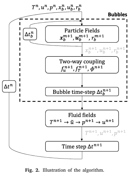

        I'm using the exact same mesh as the DNS case. So I'm sure that it is appropriate for the bubble size I use and the boundary layers heights. The thing is that I ran the simulation without the bubbles, and I got the correct results. Add the bubbles: I don't get the correct results. I'm not sure why, and I've been trying to figure it out for ages. One thing I was thinking was that maybe the way Fluent handles two-way coupling is not the same as the paper whose results I'm trying to reproduce. I'm sending you a screenshot of the paper's in-house algorithm. Are you able to say if this is the same algorithm used by Fluent? I didn't find such an explicit illustration of Fluent's algorithm in the documentation, so I have trouble comparing the two...
        Thanks a lot.
      That looks about the same as the slides in the training materials, check the Solver chapter in Theory Guide too. Check you've not switched on the node smoothing or source term linearisation (DPM Numerics).
      Re the mesh. Without knowing how the DNS solver is coded (and I'm not reading the paper!) I can't comment, is that code cell or node based? That would mean the same mesh is treated differently.

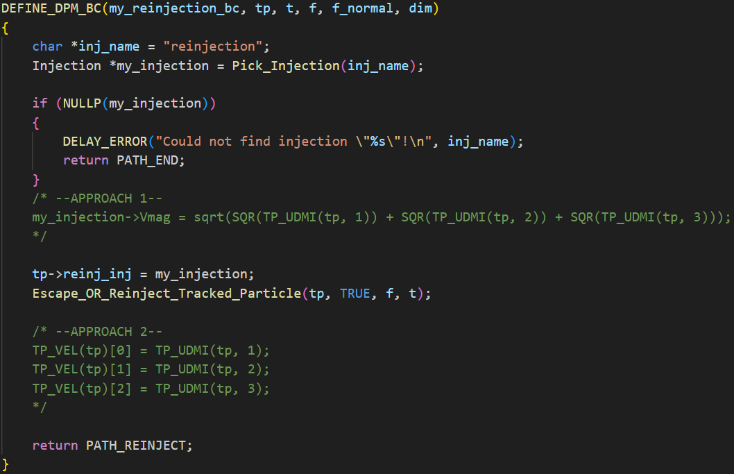

        I won't ask you again to read the paper, don't worry. Sorry about that, by the way... Anyway, I've noticed that when the bubbles reach the top in the paper, they are reinjected not with zero velocity, but at the local fluid's velocity (at the reinjection point). I tried implementing that inside the DEFINE_DPM_BC function I already use to handle the reinjection. Both approaches (see pic below) I used lead to SIGSEVs. The other examples for that function in the doc aren't helping. I know you can't comment on UDFs directly, but any ideas on how I could implement that? My reinjection injection inside Fluent uses randomized starting points and injects using the face normal's direction. I could set some constant value for the velocity magnitude (inside Fluent), but I feel like there should be a better option. (In the pic below, TP_UDMI(tp, x) is the xth component of the fluid velocity at the bubble's position)
      Check whether reinject is actually a DPM boundary option. For injections it’s DEFINE_DPM_INIT and you’d then work with the PP_ macros to define position, mass etc. The TP_ macros are for after the particle is in the domain and it’s then a Tracked Particle.
