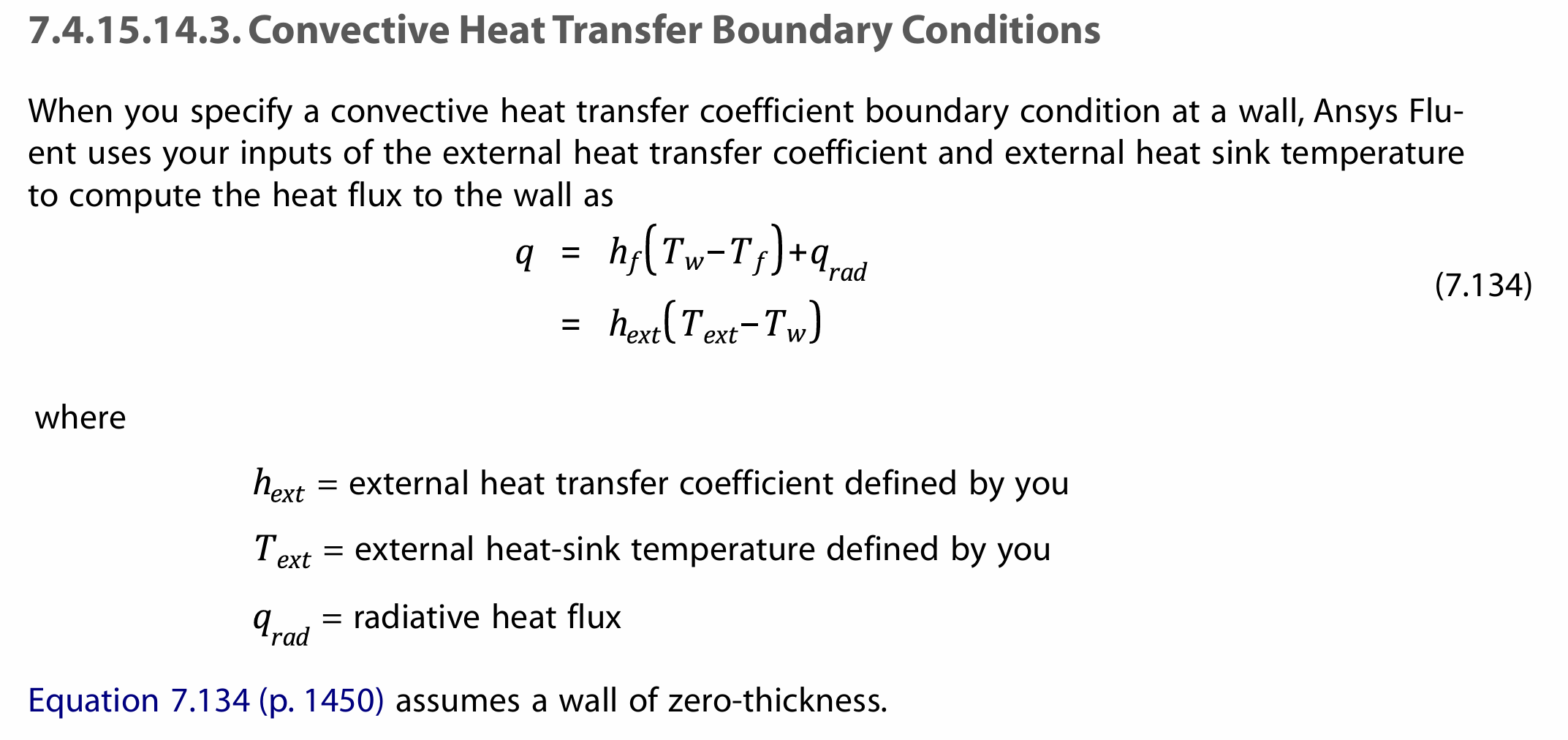

I am using ANSYS Fluent and have selected the convective thermal boundary condition. Is the free stream temperature mentioned in the set-up menu the same as T_ext (equation 7.134) in the User Guide? If not, what are the free stream temperature, T_ext and T_f?

May I please know which version of Fluent you are using? And if possible, could you please attach the image of the equation? Thanks.
