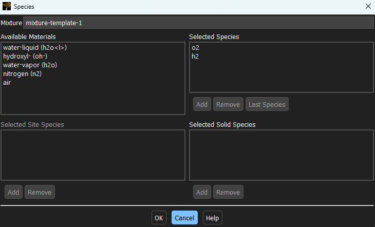

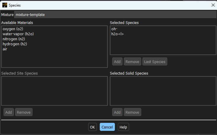

      I am modeling alkaline electrolyzer with eulerian-VOF and species models. Please let me know how I should define phases according to chemical reactions
      Is this correct? The primary phase is H2O(l) and OH-. The secondary phase is H2 and O2.

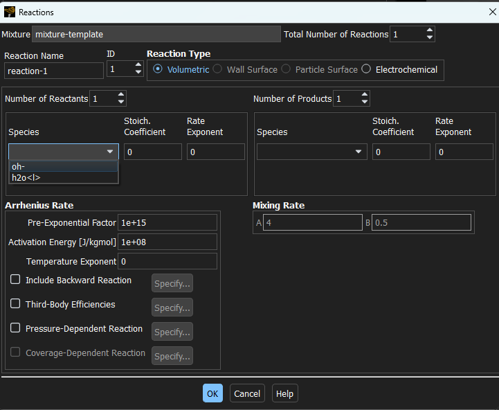

      But the problem is in defining electrochemical reactions in the species model. Here you can see I set the phase 1 as a mixture-template and in reactions I have only these two options.
      Same in the case with phase 2 which is named as mixture-template1
      Please let me know how should I define the phases so that I can set up the reactions according to the formula
      Muhammad Asim Sarwar

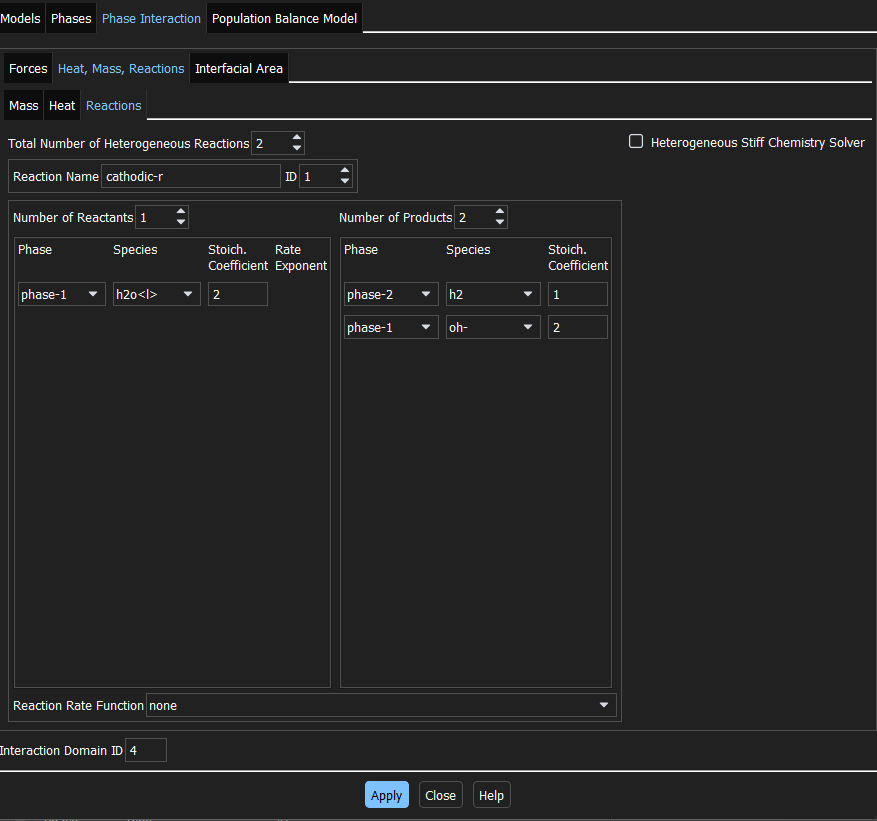

      You've defined the phases as the two mixtures - that's correct. Have a look in Phase Interaction for the chemistry but first turn the species reactions off.
    • muhammad.sarwar
      Hi Rob,

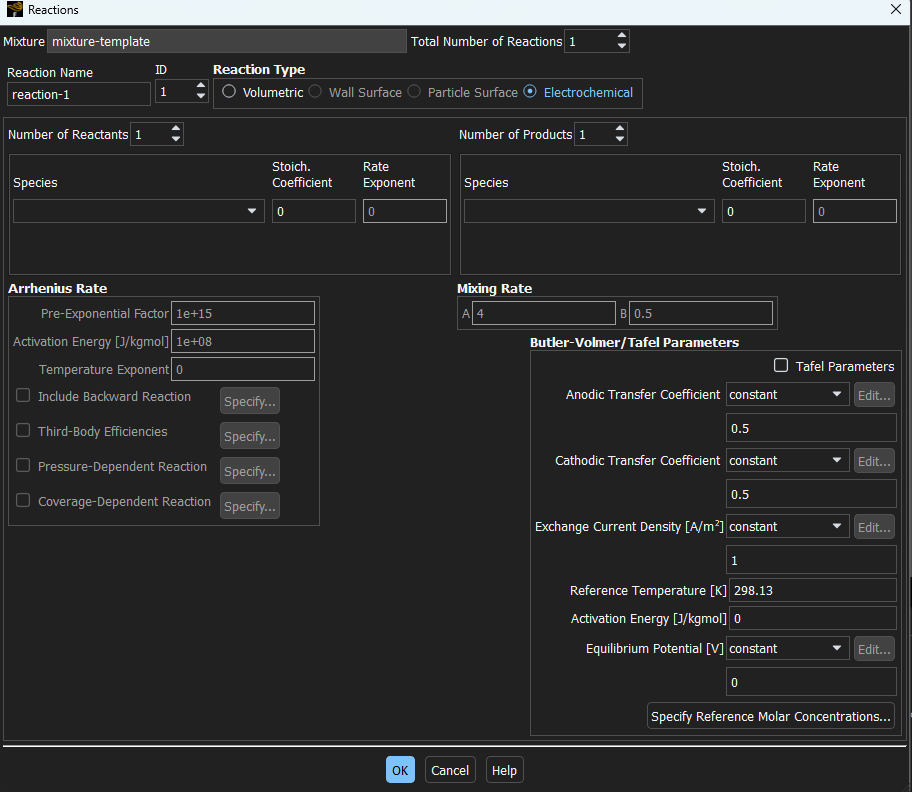

      Thanks for the answer. I checked in the phase interaction for the chemistry. First, heterogeneous reactions mean reactions occur within the fluid, right? However, in an alkaline electrolyzer, the reaction occurs at the electrode wall.
      Secondly, in a heterogeneous reaction, there is no option to set the transfer coefficient and exchange current density, which are available in the species model. I need this since I want to model coupled electrochemistry, fluid, and energy models for the domain I have.
      Asim
      If the reaction is on the wall, then it's a surface reaction?

      It is a solid electrode. The domain consists of: Cathode Current Collector, Cathode Electrolyte region, Membrane, Anode Electrolyte region, and Anode Current Collector.
      At outer surface of cathode and anode current collector I have to give ground and potential, respectively. At interface between current collector and electrolyte region I have to give electrochemical reactions.
      As mentioned earlier, I have to include the electrochemistry, two-phase flow and energy physics. Also, I have to include the bubble affect on the butler volmer equation.
      If I select hetrogenous reaction in multiphase flow, there is no option to specify the exchange current density as opposed to species model which has this option.
      Asim
      I see a couple of other threads on this that you've posted so I'll comment & close this one.
      One option is to do the phase change with Eulerian and then have the reactions in the gas phase. Products can be taken back to the liquid phase afterwards too. Furher details are on the Ansys Learning Hub, and aren't something I can share on here.
