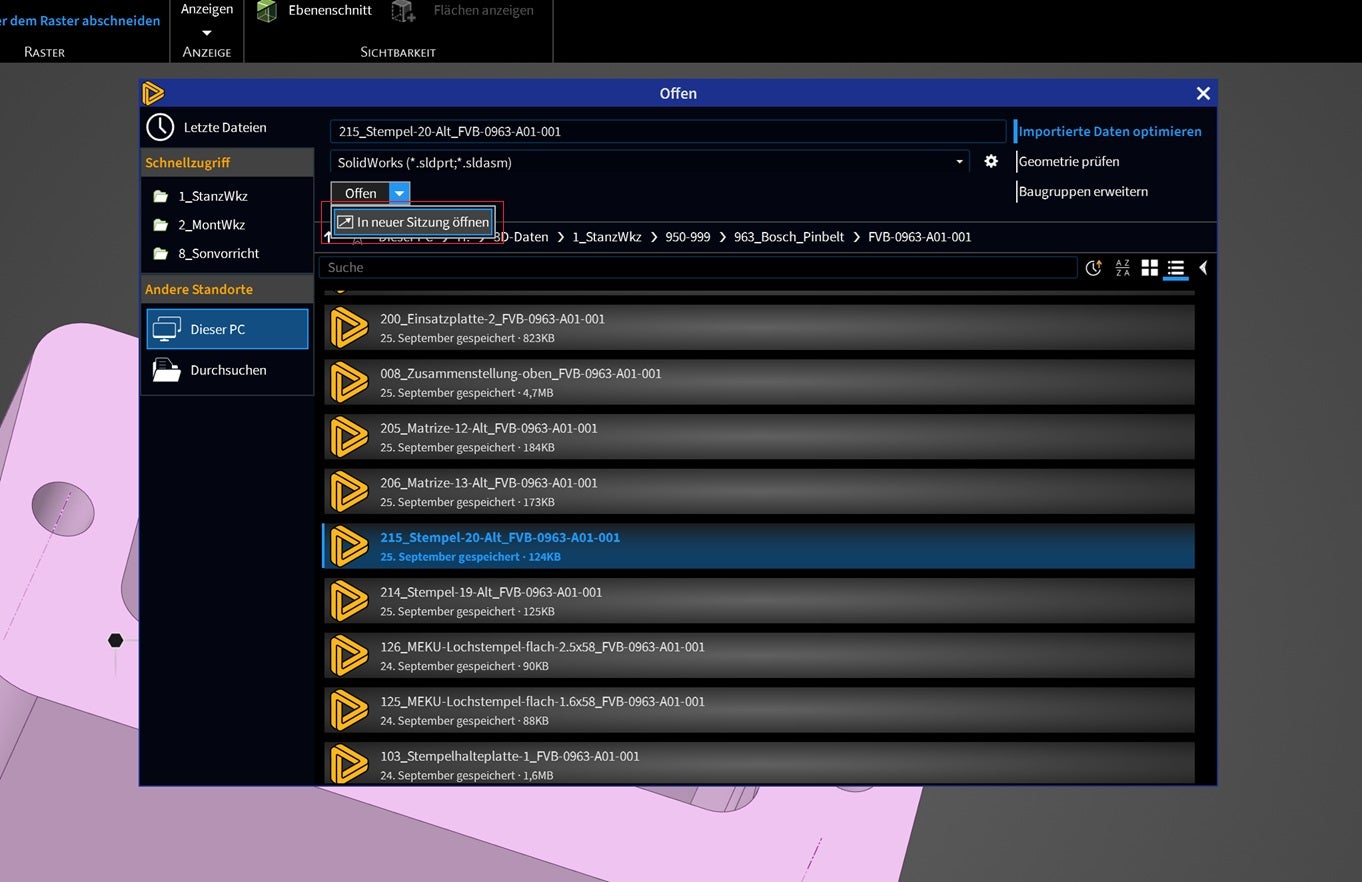

SubscriberThanks, it’s great to hear they’re working on it. I found a solution (I marked it in red) , but it starts a new discovery process, which takes a while and isn’t particularly good for the workflow.
It’s not a good solution for us at the moment.
Why is this window locked? I can't enlarge it.
Regards Chris

The solution you mentioned will pull additonal license if I understand you have a dedicated license. It does not take much time for me although it depends on the machine if multiple tasks are performed it might slow down ain some case.
Also, the Open window cannot be enlarged but can be moved to any position.

SubscriberIt works for me, but it always requires a restart of Discovery, and that takes longer than just opening a model.
I know I can move the window, but we have so many files that you have to scroll a lot.
It would be nice if you could enlarge the window in the future.
