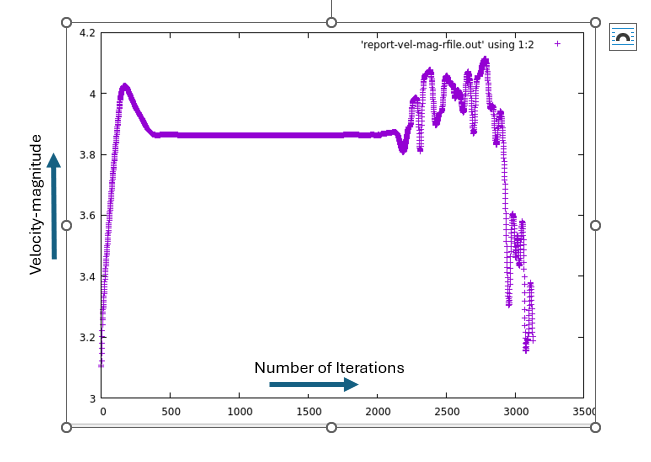

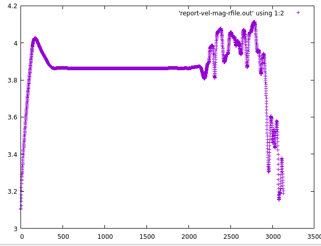

August 1, 2025 at 1:36 pm
August 1, 2025 at 1:53 pm
Rob
Forum ModeratorMaybe put titles on the plot?Â
August 1, 2025 at 2:04 pm
August 1, 2025 at 2:30 pm
Rob
Forum ModeratorWhat else is going on in the flow? One graph isn't enough to diagnose from. If you plot images every few iterations what's changing.Â

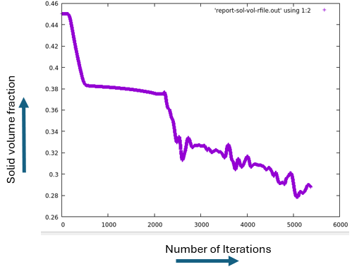

scabo
SubscriberÂ
Like i am outputting the vel magnitude and solid volume concentration with iteration to check convergence of the solution. The solution converged for 14% sand concentration but is oscillating badly when i increase the sand conc to 45%. I think the solver is not able to handle the increased solid volume concentration? Do you want some of the results? like contour plots?
To you question whats changing-i think in this case everything is changing with iteration, it is not stabilising.Â
August 1, 2025 at 3:06 pm
Rob
Forum ModeratorIf you have a higher volume fraction what might be happening in the pipe? The solver can handle the flow, but can you have a steady state solution, or is it transient?
August 1, 2025 at 3:10 pm
scabo
SubscriberIf i have a higher volume fraction, then the interaction between fluid and solid increases and also settling will increase, etc. I can run a transient case but other papers have got satisfactory results using a steady state approach which is what i am trying to double check.
August 1, 2025 at 3:13 pm
Rob
Forum ModeratorAnd if settling increases is there an equilibrium state? I can't comment on the paper, nor what settings were used as you've not shown me anything other than a (poor) mesh and a plot.Â

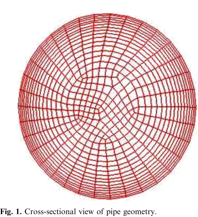

SubscriberI have improved the mesh from then and the solution converges for the 14% one. The aspect ration of mesh near wall is now around 2-3. The first layer height is 3e-4 m and 5 layers with a Growth rate of 1. The y+=50. Reducing the y+ to 30 gave poorer results when compared to exps. I have attached the mesh-Does it look fine?
August 1, 2025 at 3:29 pm
scabo
SubscriberAs for the papers they have steady state used phased simple algo with mom 2nd order and all 1st order. i have used the same. Does the multiphase parameters like drag law, specularity coeff, rest coeff affect the convergence?
August 1, 2025 at 3:34 pm
Rob

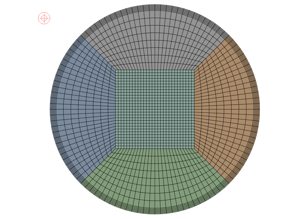

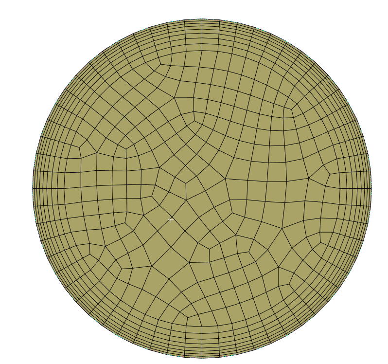

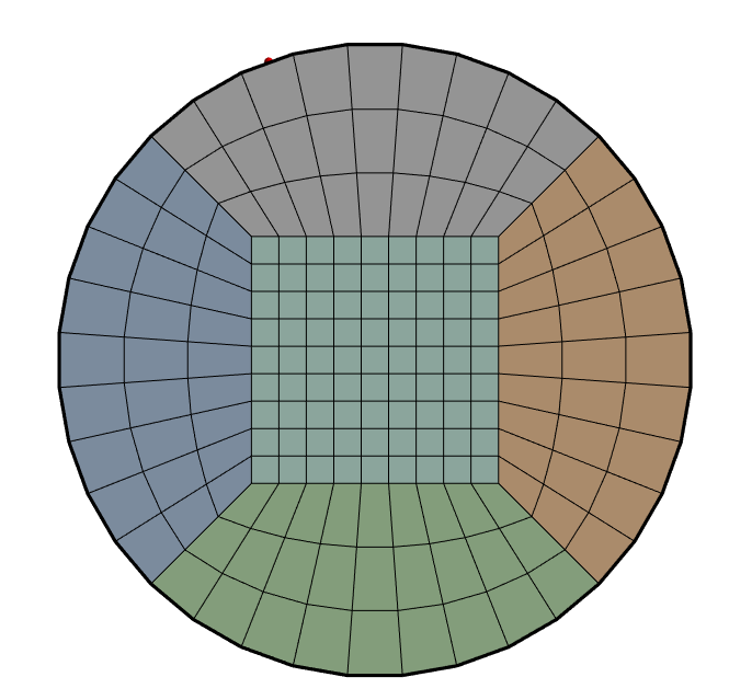

Forum ModeratorAnd the jump in cell size from inflation layer to core mesh? There's a reason we use pave meshes rather than O-grids. I've not built an O-grid in over 20 years as there's no need.Â
August 1, 2025 at 3:38 pm
August 1, 2025 at 3:44 pm
Rob
Forum ModeratorThat's a pave mesh. Inflation is a little excessive though.Â
August 1, 2025 at 3:49 pm
scabo
SubscriberOkay-i thought the mesh needs to be well oriented and symmetric and looking good. Thats why i went for the O grid mesh. I thought the above mesh is bad, but you are telling it might be better.
August 1, 2025 at 4:06 pm
Rob
Forum ModeratorBut is the flow well aligned with the O-grid when you have significant settling of the flow? The swept pave is also aligned with the flow too. There's a very good couple of slides in the training course but not so sure if it's in the AIS content covering the benefits of hex and tet for aligned and cross/off axis flows.Â
August 1, 2025 at 5:48 pm
scabo
SubscriberHi-thanks. Yes the flow can become asymetric when theres settling. I will have a look at the results and come back here.
