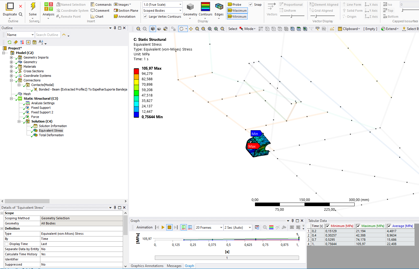

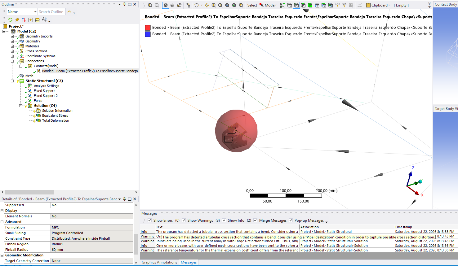

I am encountering issues with my static structural simulation. My current goal is to connect a beam element to a solid body. I have tried using an MPC formulation; however, the results do not display the stresses across the entire geometry. Interestingly, the deformations are visible throughout the entire model.

Forum ModeratorHello, try the following:
- Go to Solution
- Insert→ Beam Tool
Review:
- Bending Stress
- Combined Stress
- Axial Stress
