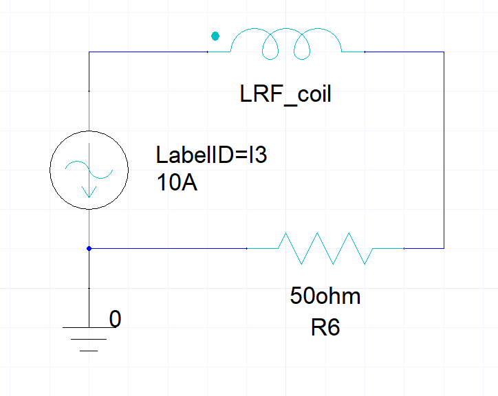

SubscriberHello everyone, I am currently using the Maxwell 3D Eddy Current Solver to obtain the electromagnetic field of a coil, but I am running into a severe issue when trying to drive it with an External Circuit.
My Setup:
Solver: Eddy Current.
Excitation: External Circuit containing an AC current source (10A at 60 Hz, I plan to make this test case work then move to high frequency regime).
Geometry: I have set the coil terminals to be the two cross-sectional ends of the solid coil. I ensured these terminal faces are exposed (touching the boundary of the vacuum region) and assigned the solid body to a Winding.

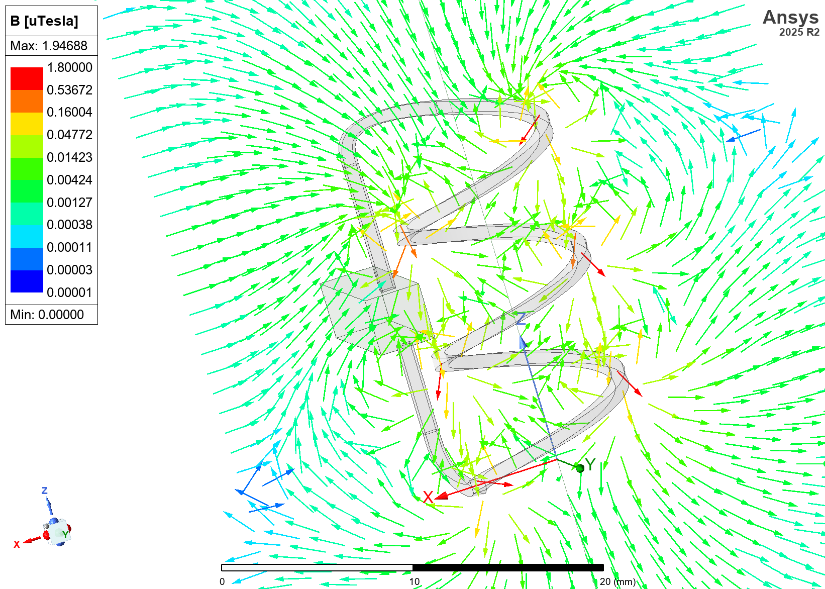

Direct Current Excitation (Working): The J vectors are perfectly uniform and parallel, flowing straight into the coil as expected.
External Circuit Excitation (Failing): The J vectors are completely chaotic, pointing in all directions and forming swirling vortices on the terminal face.
The Problem: When I run the simulation using the External Circuit, the resulting magnetic field magnitude is significantly lower (almost non-existent) compared to a control test where I drove the coil using a direct 'Current' excitation on the faces.
To investigate, I plotted the instantaneous Current Density (J) vectors across the terminal cross-section.
Because of this, I suspect the net current did not successfully entered the coil. However, the model could pass the Validation Check. I have also made sure that the vacuum region does not overlap the terminal faces (the terminal faces are coplanar with the outer boundary of the air box).
Since the direct current excitation works perfectly but the external circuit yields these unphysical, swirling vectors at 60 Hz, what could be causing this? Is there any strict boundary alignment rule or a specific meshing requirement for External Circuit terminals that I might be missing?
