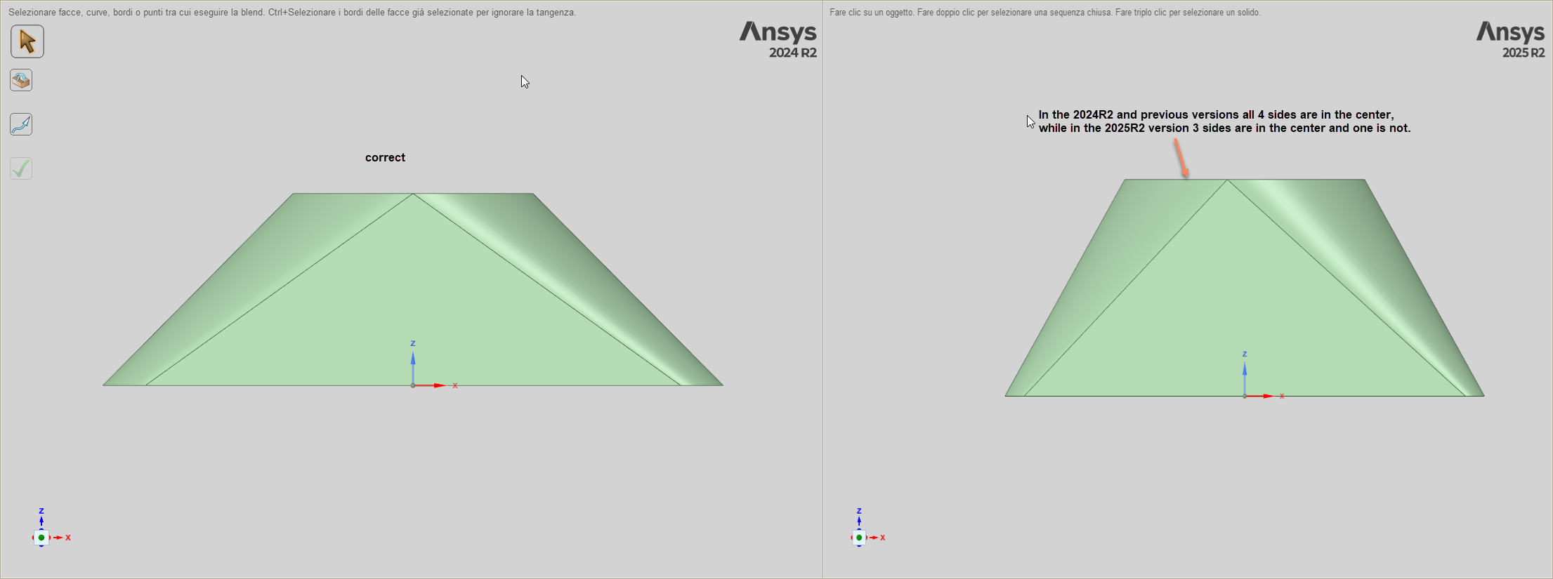

SubscriberWhen sweeping from polygons to circles, it is always best practice to put end points on the circle. This is not just a Spaceclaim thing, but also SolidWorks, Inventor, etc. Try having the circle be four arcs. That way you have control of where the guidepoints are.
Many years ago I had a similar problem in SolidEdge and the above approach that always solved it. Sometime the automatic way works, but sometimes the software needs to be coaxed to the right solution.

SubscriberHi Thank you , Yes I used this method, but spaceclaim always worked without doing the procedure you told me.

SubscriberHi, I'm attaching a photo and a video regarding the hopper not creating the lines in the center for the 2025R2 version. I've found a workaround so far, but it's still more cumbersome.
If you can get the 2026 version to create the hopper like the 2024R2 version, that would be fantastic!Link video https://app.screencast.com/J3zjqrSJo3rxE
