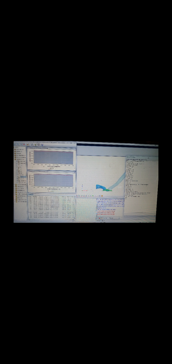

Hasan
SubscriberI have looked at Forte tutorial diesel/ gasoline using sector nesh but with a student software it doesn't work. Now tried selection of diesel and gasoline from the fuel_library.cks file and running tutorial 5 PFI tutorial. Diesel 10% & gasoline 90% with all selections as per tutorial, I think it will crash when ignition CA is reached. Mostly I need to change something in the Flame Speed Model tab.Â
Thanks.
