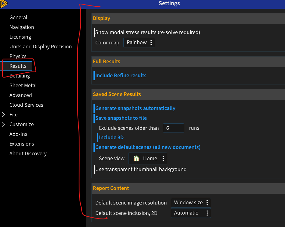

      I also noticed another thing that doesn't seem to be working properly.
      When I have a file with several scenes and several simulations like the first image in the attachment, when I save the report with all the scenes it doesn't include them, it inserts them at home sometimes one yes and one no or none or all of them for each simulation.

    • Devendra Badgujar
      Hello Roberto,
      When you have simulation copies those will also come in report including all the saved scenes that you defined. I tried and it works.
      I tried with a sample heat sink example. Make sure you use this settings:
      Devendra
