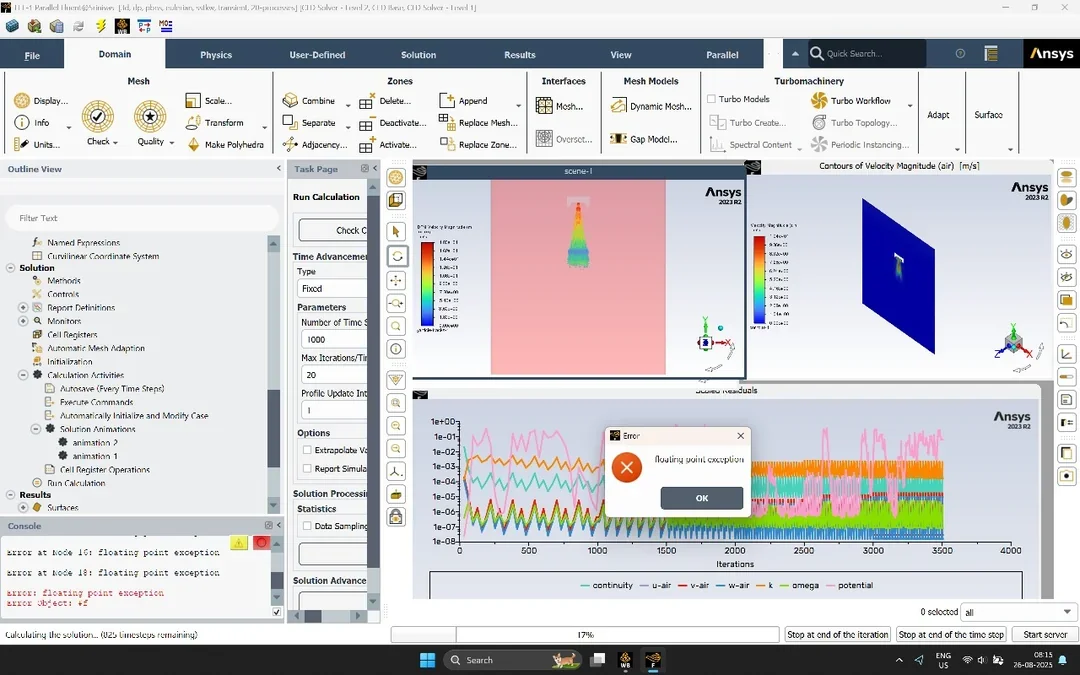

SubscriberI am conducting a CFD analysis of the Electrostatic spray coating process in ANSYS Fluent, and I am currently facing an error of floating-point exception (image 1) after 8.5 hours of runtime. As there are many parameters to tweak, I'm getting confused about what to change now.

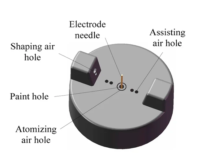

Geometry (image 2): domain of 0.3 x 0.3 x 0.4 m. The distance from the spray nozzle tip to the substrate (plate to be coated) is 0.25m.

Boundary conditions (image 3);
(top face of enclouser)Downdraft vel (vel inlet): 0.3 m/s
Shaping hole inlet (vel inlet): 10 m/s
Assisting hole inlet (vel inlet): 8 m/s
Atomising air inlet (vel inlet): 3 m/s
Side walls (4 sides): pressure outlet
Substrate (bottom face of enclouser): reflect DPM (all other walls are set to escape for DPM) and voltage of -60,000 V

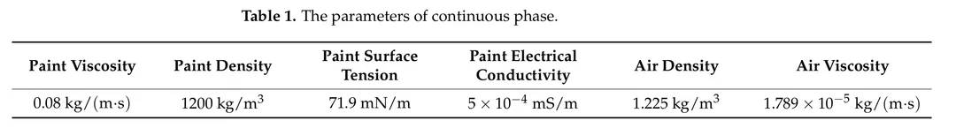

Material properties: image 4

The error is coming after 175 timesteps. Please help me with this analysis. -

Forum ModeratorThe error is point at an instability in the solution. That could be linked to mesh resolution/quality or time step size. However, the other clue is the potential residual: what's causing it to bounce like that?
You're using DDPM so are interacting with both the DPM and Eulerian Multiphase model: do you actually need DDPM?

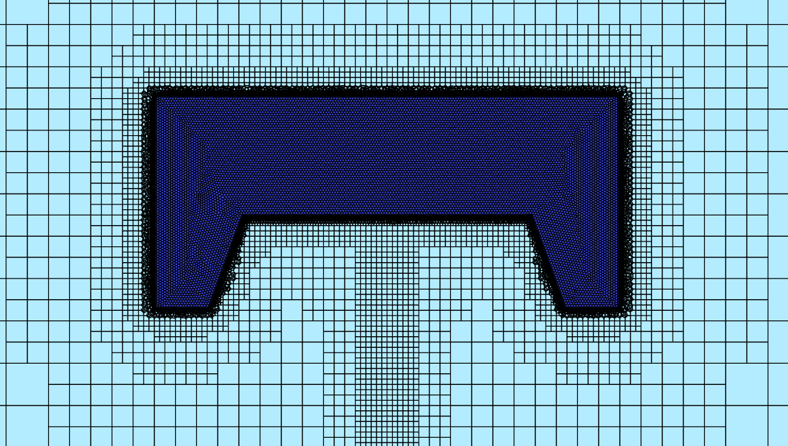

SubscriberI think I would need DPM, because I'm simulating a spray. Also, mesh resolution is enough as the smallest feature is of 0.5mm, and I've given a face size of 0.2mm with 25 layers of inflation around the nozzle body. Also, I've refined the mesh in the area of flow of spray. Below I've attached an image.
