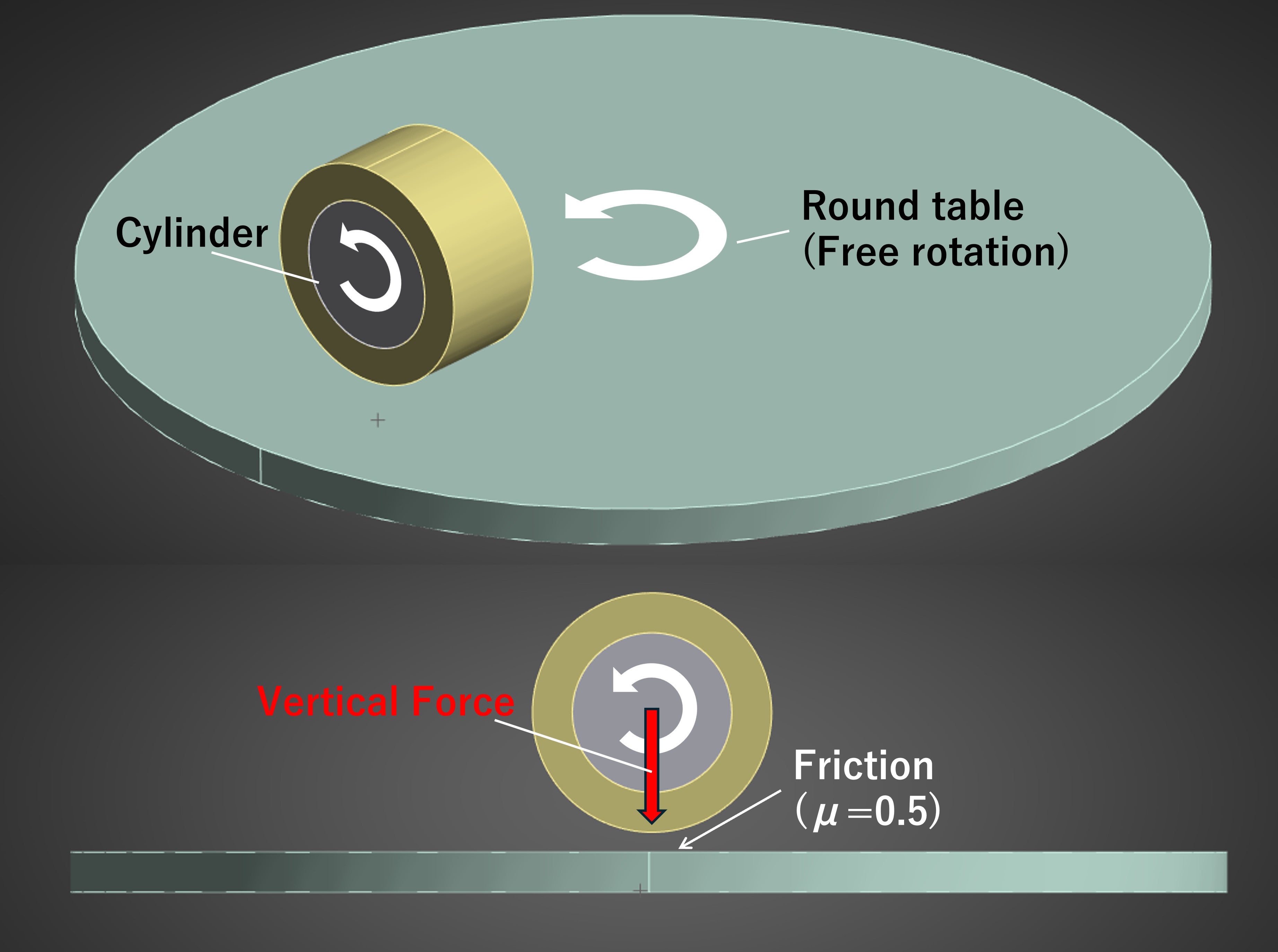

        • Fumiyoshi Abe
          I’m investigating tire noise, and I want to analyze the sound generated when a tire, modeled as a cylinder, rotates in place on the ground.Analysis model
    • Erik Kostson
      Hi
      Sound radiation for this is quite complex (real tire).
      We do not have a way to do this (in vibracoustic analysis the mesh is fixed and can not move with the tire so acoustic mesh is stationary).
      All the best
      Erik
