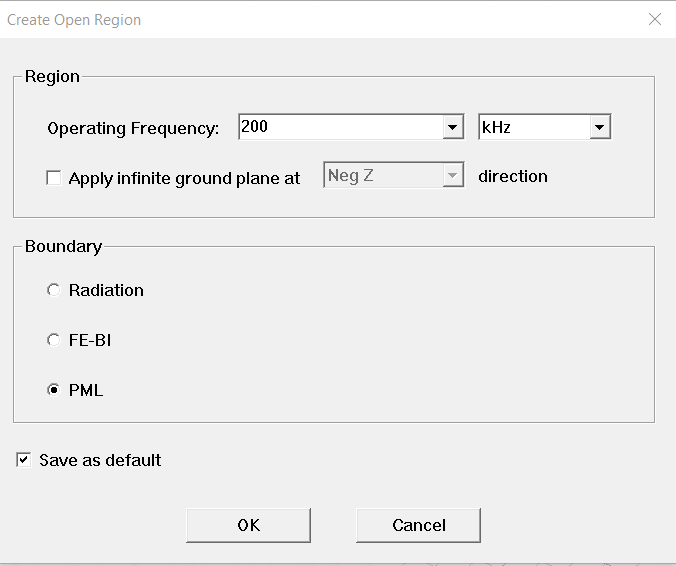

- For PML, does the minimum radiating distance have to be equaled lambda/4? ie: can it be smaller? My entire geometry is very small, approximately < 3cm. The default value is 37500cm.

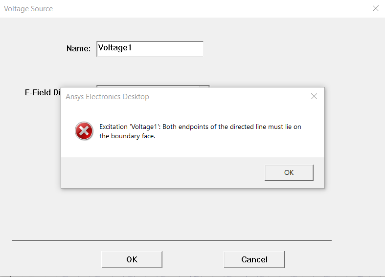

- I want to add the voltage source, but there is no place to input the value. I can't change the voltage values in the properties section as well.

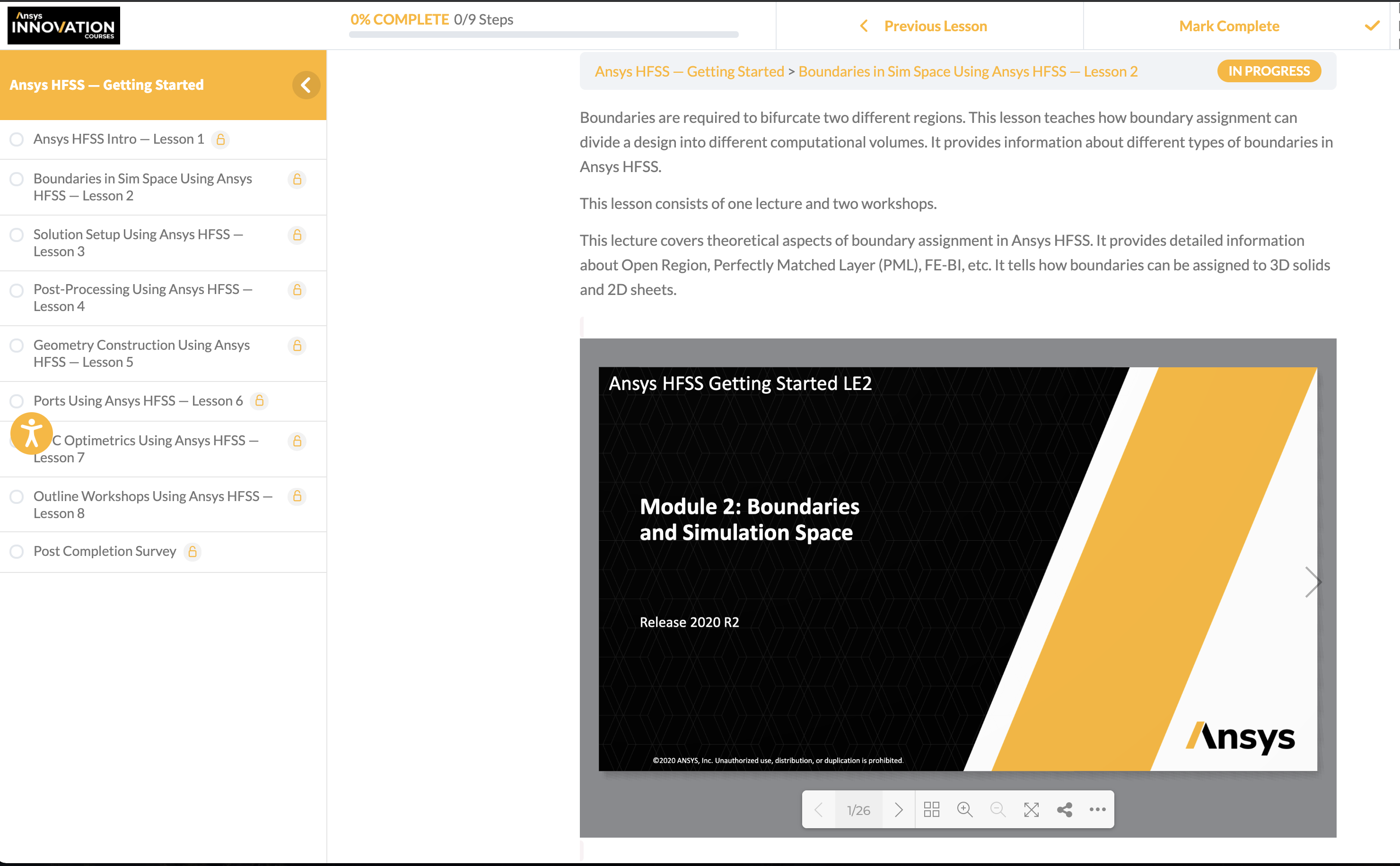

I'm reading Ansys HFSS - Getting started materials from Ansys Hub. If there is any recommended HFSS tutorial video, please let me know. Thank you.

PMLBoundaryshould be placed at leastlambda/8 distance from the radiating object.You can also useFE-BIboundary for keeping radiation box closer thanPML boundary.

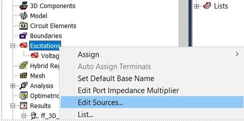

You can scale the voltagesourceby right mouse clicking on excitations and select edit sources.

Please go through our course available in AIC channel for video tutorials -Electronics Engineering Courses | Ansys Innovation Courses
You can also browse the videos available on ouryoutubechannelshttps://www.youtube.com/user/ANSYSHowToVideosandhttps://www.youtube.com/c/AnsysLearning

As of nowonly PDF version is available for getting startedcourses.If interested you can go through other availablecourses for video tutorials.

I have additional questions for adding the voltage source. I want to learn about E-field across the geometry. Can the directed line be perpendicular to the face (in y direction) that I will apply the voltage on? if not, how I should assign this line? It seems like the directed line can only go along the x- and z-direction.
Thank you.
