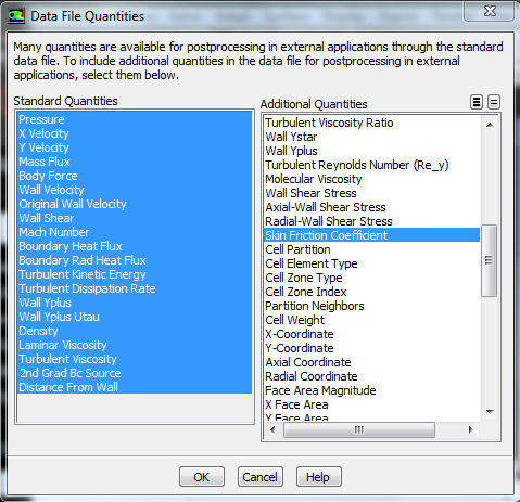

Set Up Data Export
In addition to the standard data quantities, we would also like to view the results for the Skin Friction Coefficient. This quantity is not transferred to the post-processor by default, so we have to do it manually.
File > Data File Quantities
Under Additional Quantities, select Skin Friction Coefficient, which should be roughly halfway down. Your window should now look like this:
